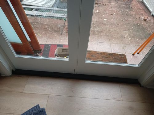

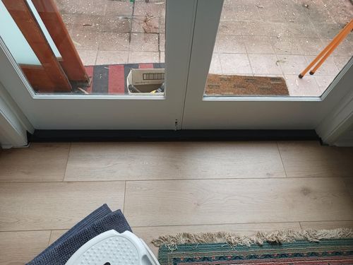

thanks again Eric. I've mostly finished the room and am now the world's biggest jigsaw fan. The last thing I need to do is install something on the sills of the two sets of french doors to bridge from the new planks to the existing sills. Yes, there are two sets of french doors to this room. The larger, external ones (1860mm wide including gaps at ends) are depicted. The smaller ones (the internal entrance) are 1250mm wide with gaps at ends. To cover nicely, whatever I use needs to be about 90mm wide and I'll need to cut the ends to shape around the frame and gaps at the ends. They can't be too thick (2-4mm). Any suggestions much appreciated.

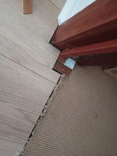

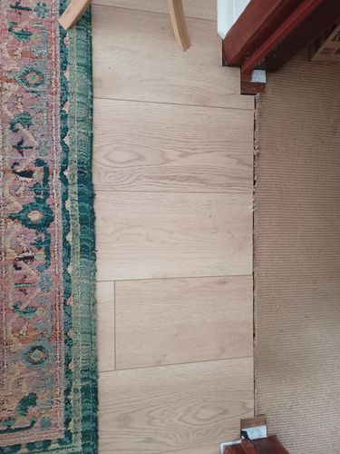

You’ll note from the attached photos, I’ve done a pretty shoddy job fitting the planks to the door architraves (should have trimmed the bottom of the architrave and cut the planks to slot underneath), so have been thinking a wider threshold/transition trimmed to tightly abut the architrave on either end (and extend a little beyond) would hide the end gaps (with both sets of French doors). Adding a narrow strip of flooring to the wider sill to reduce the gap to 20mm doesn’t address the gaps around the architraves.
Given I have spare planks, I could recut the ends to better abut/underlay the architraves, but admit, having destroyed a half-dozen planks early in the installation as I tried to understand how they lock together (hitting too hard with the rubber hammer, not inserting the full length at a sufficient angle prior to lowering, etc.), I have absolutely no confidence I could remove and replace a single plank successfully.
Perhaps my idea of a quite wide transition to cover my errors is too much of a hack job. If I unbundle the two problems (the long gaps and the end gaps), perhaps you have some ideas?
The large French doors open outward and are positioned beyond the gap, so the height of the transition trim won’t affect door function. I could do as you suggest and insert a strip of plank to reduce the gap to 20mm or less and use something like (25mm wide) https://www.bunnings.com.au/qep-25mm-x-2-5m-transition-cover-trim_p0227346 or (40mm wide)  https://www.bunnings.com.au/roberts-3-3m-silver-floating-floor-junior-trim_p6823234 to cover the long gap.

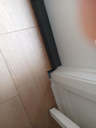

The smaller french doors open inward over the gap, so the height of the transition trim is important (space is tight). I note that the height of the first listed trim preceding (QEP 25mm x 2.5m Transition Cover Trim) though 25mm, would seem to include the centre spline which would slot into the gap, so I think it would be reasonably low profile and could work.
Having installed transition trim as described over the long gaps, I could then fashion small, sympathetic cover plates of thin wood/metal to insert over the end gaps.
