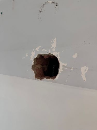

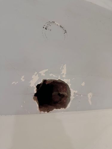

We removed a split system aircon from our wall and there is now a hole through the single brick wall connecting to our garage.
what would be the best method of filling this hole and the plastering up the wall ready for painting?
I was thinking a 2-part foam for filling the space?
Hello @Bprice88
Thanks for sharing your question about your brick wall. I propose using Parfix 340g Expanding Foam Filler to partially fill the hole. Once the foam has cured, I recommend using Dingo 10kg Mortar Mix to fill the front of the brick wall.
Hi @Bprice88
I would be inclined to use something more solid than expanding foam which isn't intended for this type of application. Instead use liquid nails to secure a block of timber or even a brick off-cut. Then builders bog the gaps ones the insert is set in place, Apply a smooth coat filler across the top, prime coat and paint.
