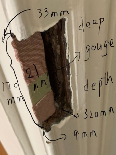

How to fill the holes and gouge in my door?

@MitchellMc Thank you! My wish is installing a new handle. About the door itself ,the holes is near but not on the spot I will drill for handle.(image1) . But door frame is different It may be very very near the drill spot. And one surface is made by concrete.(imag2). How to fill it so that I can install a handle? Certainly bog is best because it can be drilled. I think detailed advises is very best. Also which handle is very important .

As to which plastic wood filler to use I have no preference as they all seem to do the same task. the issue I had was finding the correct mix of hardener to filler ratio to shape or mould the shape before the hardener sets the filler. The other issue was the workability of the plastic wood after setting. Too much hardener sanding hard work not enough hardener the sanding material clogged quickly.
End result I try to fit a new section of suitable timber in and fill small gaps with wood filler/putty. Down fall longer repair time upside better finish. Horses for courses. I think for memory I mostly used the plastic wood you suggested.
