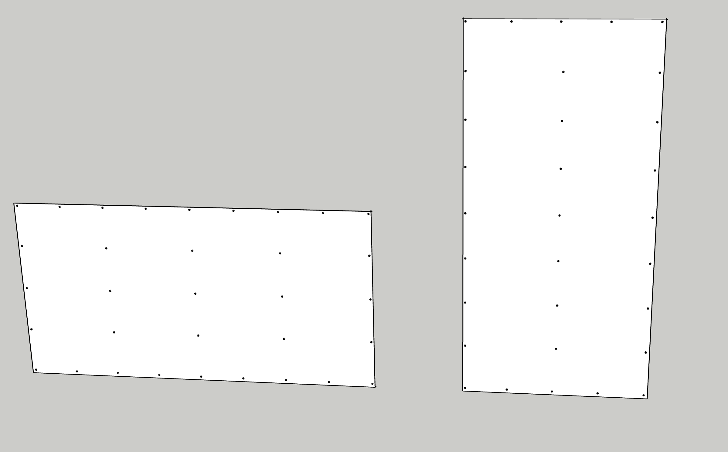

To attach the acoustic pinboard to a masonry wall, I would be using green wall plugs with button head screws. These Zenith 8G x 30mm White Button Head Screws would be ideal as the heads are white, and they would blend in nicely.
I'd suggest having a screw every 300mm around the perimeter of the board, with a row of screws every 600mm in between. Depending on orientation, it would look like this.
This would ensure the pinboards are extremely well supported and would sit flat against the wall long term.
