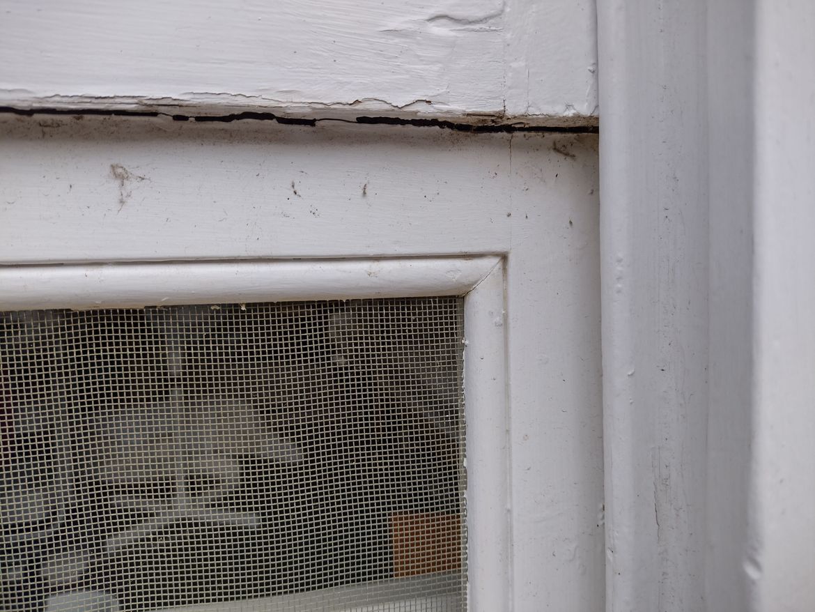

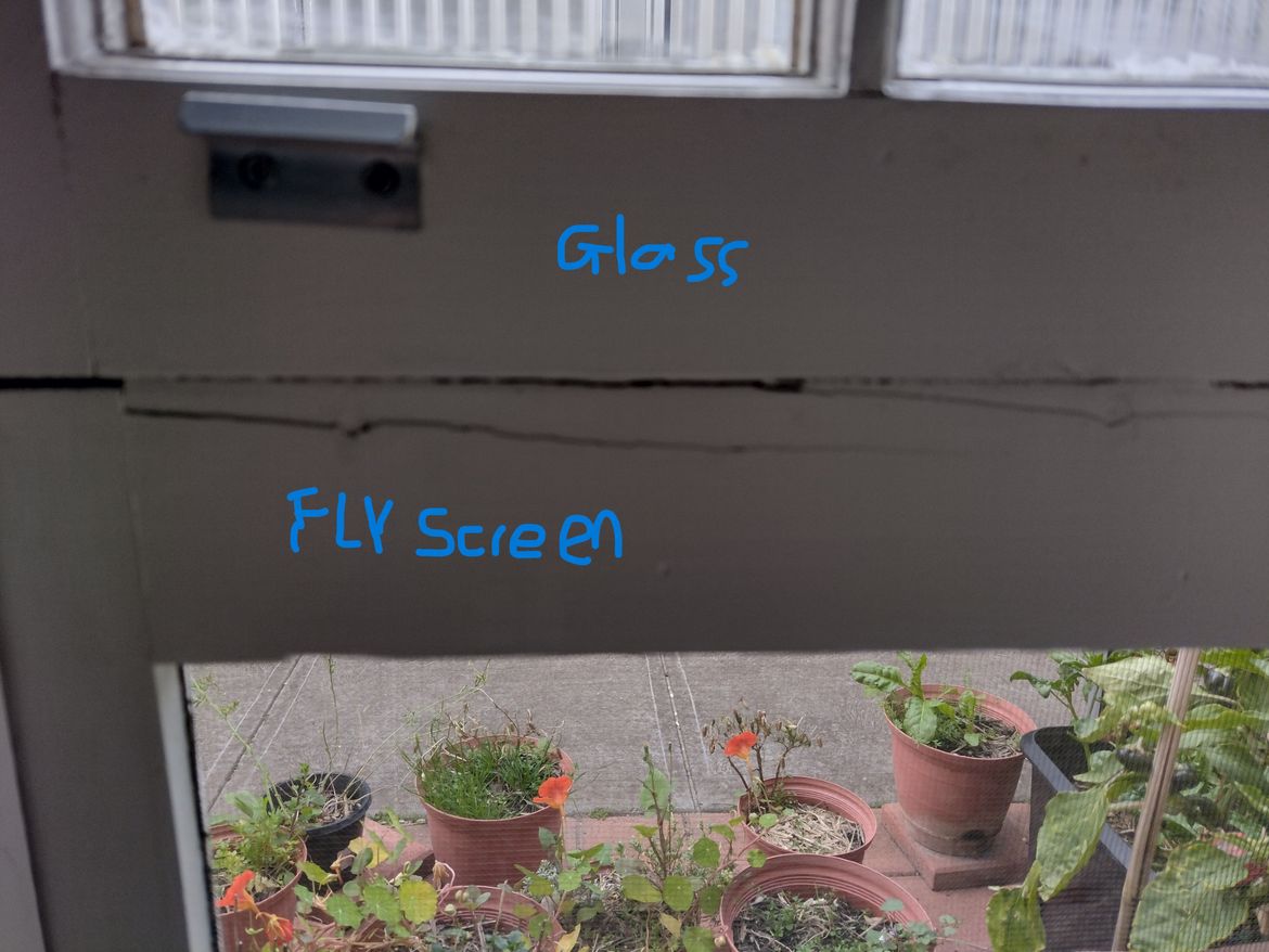

I have some sash windows (up and down motion) where there is a crack in the lower (fly screen) portion of the timber on the interior side. This can be seen on Image 1. Image 2 shows how the join between the two window sections there is a gap (compare to another window image 5).

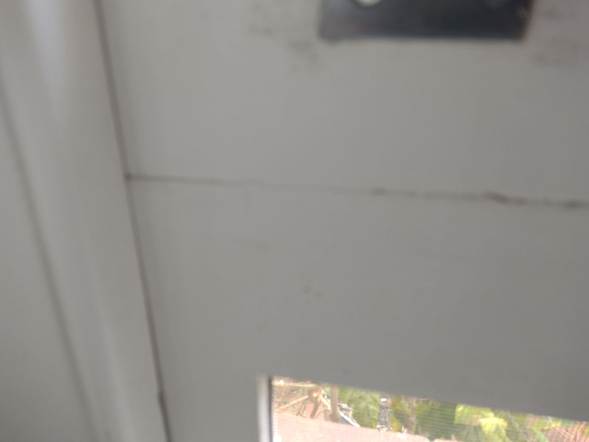

Initially I thought a plate of some kind however as per image 3 it closes too snug for anything however thin to fit e.g. https://www.bunnings.com.au/carinya-100-x-100-x-25-x-1mm-galvanised-l-shape-make-a-bracket_p3960650.

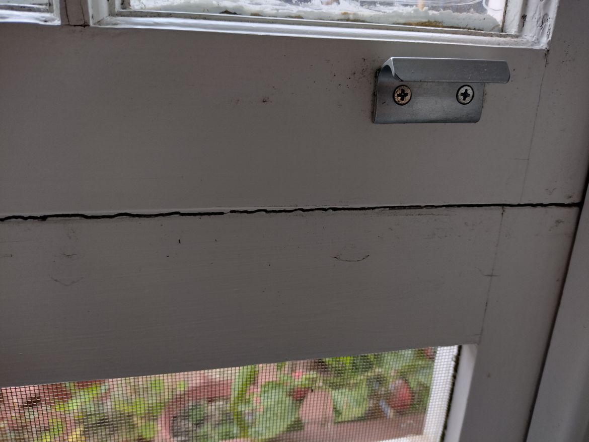

Outside looks ok for the moment (image 4)

SamMacImage 1 Cracked sideImage 1 Cracked sideImage 2 -  other sideImage 2 - other sideImage 3 - ClosedImage 3 - ClosedImage 4 OutsideImage 4 OutsideImage 5 comparison windowImage 5 comparison window

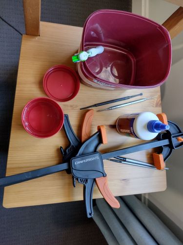

Update on how it went. Got the aquadhere as recommended.
 First got all tools together and did a dry test to make sure i could pry it open enough to get a small get brush in.
Then went ahead with the actual 'painting' of the glue into the cracks
Went well, a bit fiddly to really push it in to the thinner sections, and made sure to have damp towel on hand to wipe up excess notably when clamping some squeezed out.
Then clamped it up as shown for 8 hours.
That was Saturday morning now Thursday afternoon and its still in place and set, while still visible no looseness along the crack at all!
