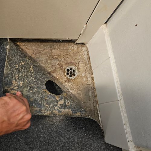

How to fix sagging floor?
ffaisalb
I am trying to look for a way to fix the sagging floor, have attached the picture, could any one give any leads or ideas?
Re: sagging floor

To properly fix a sagging floor, the first step is to figure out what’s causing it. The most common issue is that the subfloor has either degraded over time or isn’t properly supported underneath.
Are you able to access the area under the house? If so, it’s worth having a look underneath to check for things like rotted or broken joists, sunken stumps, or missing supports. If you can identify the problem from below, you may be able to reinforce the structure and carefully jack the floor back to level.
If there’s no access from underneath, unfortunately, the only way to address it would be to remove the floor covering from above and inspect or replace the subfloor from that side. Once the cause is identified, you can then determine the best method for repair.

Whats is the best material to use below, cement? Or mortar, please excuse my ignorance.

It sounds like you might be looking for a product to fill the depression in the floor rather than lifting and reinforcing the structure underneath. In that case, a self-levelling cement compound could be used to even out the surface, but it’s really important to understand why the floor has sagged in the first place.
If the subfloor or joists underneath have degraded, or if there’s moisture damage, simply filling the dip won’t fix the underlying issue—and the problem could worsen over time. I’d strongly recommend engaging a professional to assess the subfloor and check for any signs of rot, structural movement, or dampness before proceeding. That way, you can be confident you're not just covering up a bigger issue.

We initiall thought it was the water from nearby sink, but my plumber freind said it would have moulded and he said ti stop all the taps and check if there is a water leak the main water meter will still keep  running ? In the case it needs to be dugged in deep in case there is a leak of something below. He said some times it just gets weak below?
Could you recommend another tradie? Any input is always highly appreciative?
I do want to spend some money if needed and fix it rather then causikg trouble later especially since its an old building.
I am in Western Australia, not sure if that helps?

Sorry, @ffaisalb. Just taking another look at your image, is it a concrete floor? I initially thought it was perhaps timber. If it's concrete, then it is unusual to be sinking in just one area. The flooring would typically be graded towards to floor drain, but having a sunken section in front of it is odd.
You might like to speak with a builder or concretor to get their thoughts.

It seems like the bottom is floor grate? I asked a few mates and they mentioned that, will try and get a concretor or some one?

I agree with Mitchell's recommendation, I suggest getting a builder to investigate under your house to find out the cause of the sagging. Flooring does not sag without a reason, if the builder only says material failure, then you are lucky as it will just need to be replaced. But if there is any sort of moisture damage or leak involved, it will need to be addressed first before carrying any sort of repair first.
