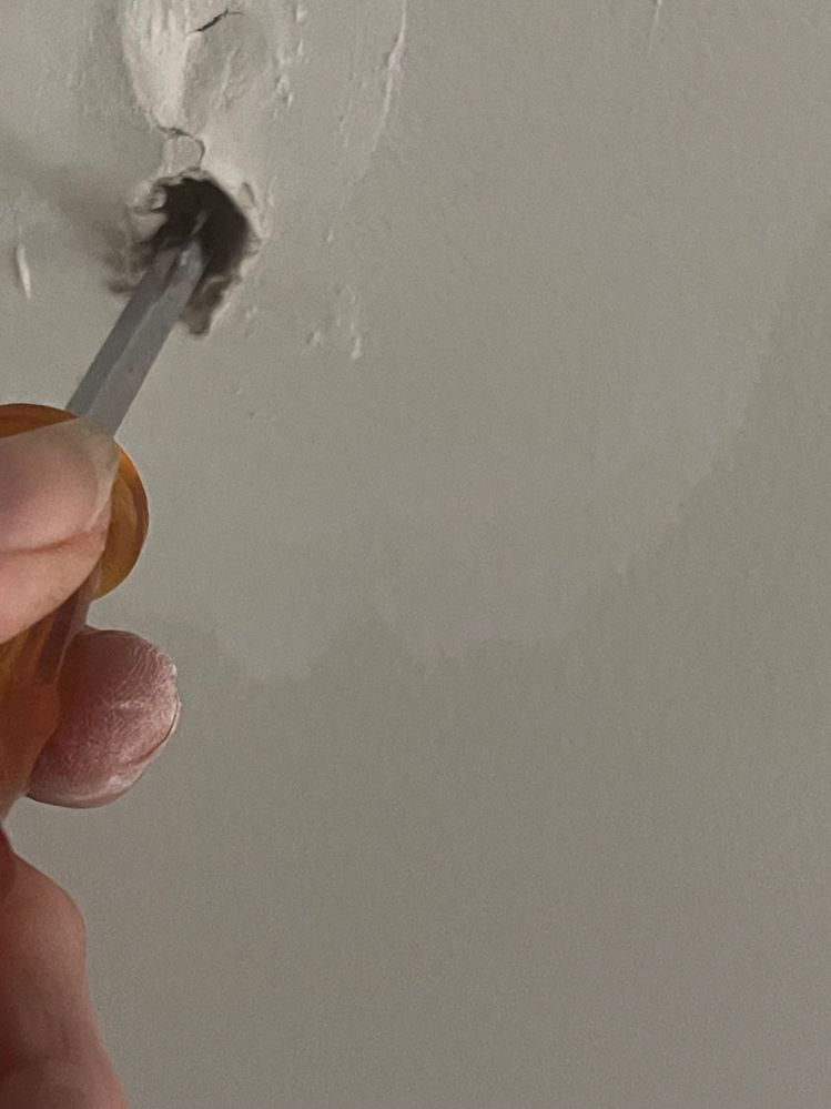

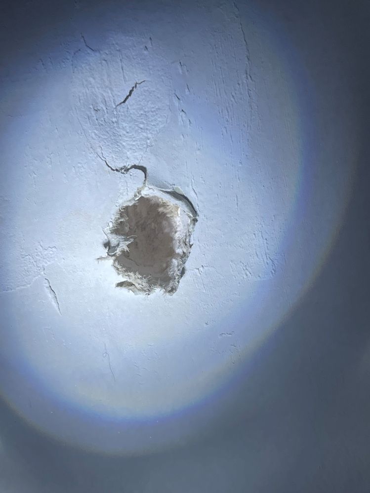

Hello, I am trying to install floating shelves, however I'm having significant difficulty. I've tried plaster plugs however they are too long and i've tried ramjet hallow wall anchor screws however in some locations they are too long and I can't secure them. It seems I can get to a 20mm depth ok then I seem to be hitting brick or something else. I can't drill anymore regardless of using a mortar drill piece and hammer drill.

it seems to definitely be masonry/concrete. Not steel. I can't get to a depth of more than 15mm before hitting brick.
I'm not sure I have the strength to drill into brick- but I'm hoping with the right connecting part that I can get it sorted.
