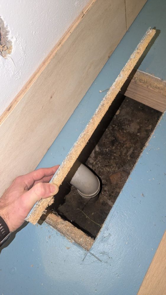

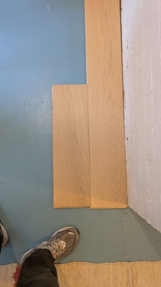

I have around a 10sqm area that I am looking to lay engineered floorboards in. The boards did not come with manufacturer instructions for laying, as I acquired them from another DIYer with surplus stock (and the manufacturer has not responded to me).
Below are two photos: 1) The particleboard and a cross section of it (this is from a section to access services but will be covered). You can see the underside of the engineered timber on the left of this photo. 2) The engineered boards.

1. The area is relatively level but for any areas that need further levelling I plan to either sand back or use self levelling compound. I understand the latter may be better but would appreciate any advice on this.
2. What is the recommended method for laying engineered timber on particle board? I have heard that nails are not recommended because they don't stay in particleboard. I would prefer to use a floor adhesive if possible.

Re: How to lay engineered floorboards over particleboard for a small area
Hi @joe19,
  1. For any minor high spots, sanding is a perfectly acceptable approach. For any dips or low areas, you will have to use Dunlop Timber Floor Level Flex Kit as it is the only self-levelling compound that I'm aware of that can be used over timber floors.
  2. You're right that nails are not recommended for particleboard, as they can easily loosen over time. A high-quality flexible adhesive, like SikaBond T55 or Bostik Ultraset, will give you a solid and durable bond. These adhesives are designed specifically for timber flooring and will accommodate any minor movement in the substrate. Just make sure to follow the adhesive manufacturer's guidelines on notched trowel size and working time for the best results.
  3. Underlay is not required and should not be used. Underlay is designed for floating floors and placing it under glued boards would interfere with the adhesive's bond.
  4. For the tongue and groove joints, using a PVA-based wood glue can help create a tight fit and reduce the chances of creaking down the track. This Gorilla Wood Glue would be suitable. Apply the glue sparingly to the groove and clean up any excess immediately to avoid staining the board surface.
Make sure to acclimatise the floorboards in the room for a couple of days prior to installation, as this helps prevent movement after they're laid.
Also, leave a 10–12mm expansion gap around all walls and fixed structures, which can later be covered with skirting or scotia.
Allow me to tag @Dave-1 and @Nailbag to see if they have any other insights they can offer.
Let me know what you think.
Hi @joe19
All the stepped out advice by @JacobZ is spot on. But just to confirm the boards you have as it "engineered" floor boards vs "floating" are often referred to incorrectly. If you have boards a min 10mm or more then yes they are engineered and follow @JacobZ directions. If they are more like 6-8mm then they will most likely be floating and a foam underlay will be required.
When using self-levelling compound, first mark out the low lying areas with chalk. A long trusted straight edge will help you work this out. Pour the compound centrally and allow it to spread. Less is better than more in the pour. Use a Bricky's float to feather out the edges. Follow the mixing instructions exactly and bear in mind it goes off quickly!!!
