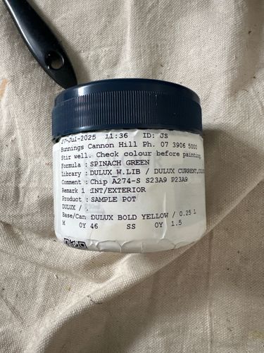

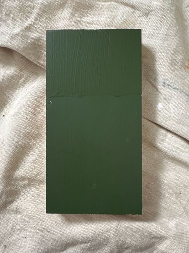

We had a sample pot of “spinach green” dulux and loved it.  We then bought a full pot, have painted the area and realised it looks different.  Are these the same… could someone help explain the labels? Thanks!

Welcome to the Bunnings Workshop community @goinggreen. It's brilliant to have you join us, and many thanks for your question about paint mixing.
Yes – based on the labels, they are the same colour and the formulas match. The difference you’re seeing isn’t because of a change in colour mix. Your 4L can simply contains around 16 times the pigment of the 0.25L sample pot, which is expected when scaling up the formula. From your photos, the painted section appears to match correctly. The slight variation you’re noticing is most likely due to the difference in sheen – your 4L tin is Dulux Wash & Wear Low Sheen, while the sample pot is designed purely for testing and doesn’t have the exact same finish. This can make the light reflect differently, especially when the paint is fresh, but the underlying colour is the same.

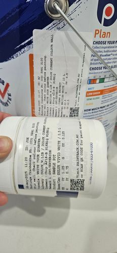

Hi, I need help understanding why my 500ml sample pot is a different colour to the 10L supplied when painted on the wall.
If I am correct, should the 10L tint be 20x what the 500ml is?

Welcome to the Bunnings Workshop community @luke1555. It's wonderful to have you join us, and many thanks for your question about paint tints.
Twenty times would be correct, though this is a Dulux colour into British Paints so formulations can differ due to the bases. I can see that it is the same Dulux colour that has been mixed up, and they have the proper colour selected on both cans. Dulux colours mixed up in British Paints shouldn't normally be an issue, but it is drawing from the British Library, which is a conversion formula. This is similar to mixing a Dulux colour with Taubmans paint; there's a chance of a slight difference. Given that Dulux and British are closely related, I'm surprised that the colour didn't translate directly and give you an exact match.
How different are the colours? My recommendation would be to return to the store and speak with a helpful Paint Expert. I trust they will help resolve the issue.

Hi Michael, thanks for your prompt reply. The colours are quite different.
Both the sample and 10L are a British paints base so I would have thought they should match. However the sample does say Dulux vivid white base. Maybe that is the cause. I will go back to the store to try and rectify.
Thanks for your input.

Hi again @luke1555. Glad to hear the team managed to resolve that for you. I was trying to get through to them on the phone ahead of you, but it looks like you're all sorted.
