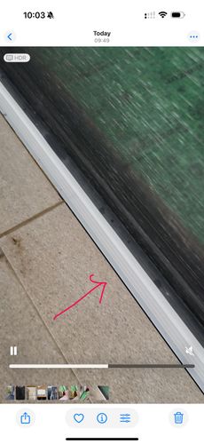

What is the best way to avoid water entering the subfloor and wetting the carpet thru the aluminium balcony frame ? The red arrow is from where I assume the water is entering.

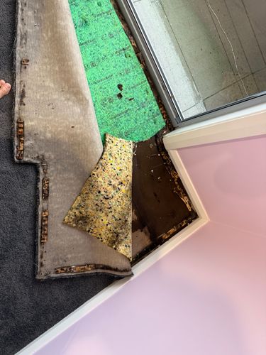

The other image is the wet subfloor inside the bedroom connected to that balcony.

I propose using Sika 310ml Grey Concrete Sikaflex Pro+ Polyurethane Sealant to seal both inside and outside the aluminium frame. I suggest letting the area fully dry off first and putting a seal on the entire edge of the aluminium frame that is linked to the balcony. Once the floor area inside your room has dried off, I also suggest a seal between the interior floor and the frame so that both sides are sealed.

I would be pretty much suggesting the same fix as @EricL has laid out. I would check the tracks for silt/dust build up as well. The corners of the edge of the aluminium plate outside is what I would be focusing on as well.
I cant see any weep holes along the outsid eedge of the window tho they must be there, I would check them to see if they are clogged up at all as well.
