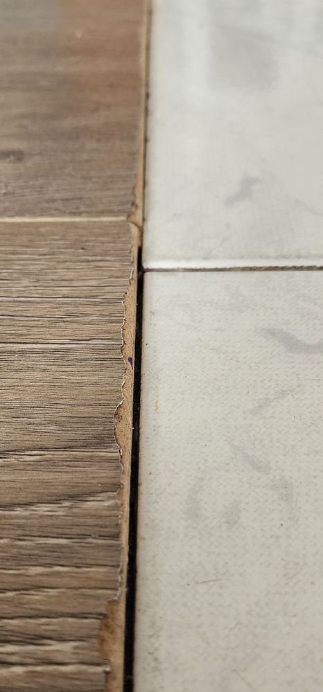

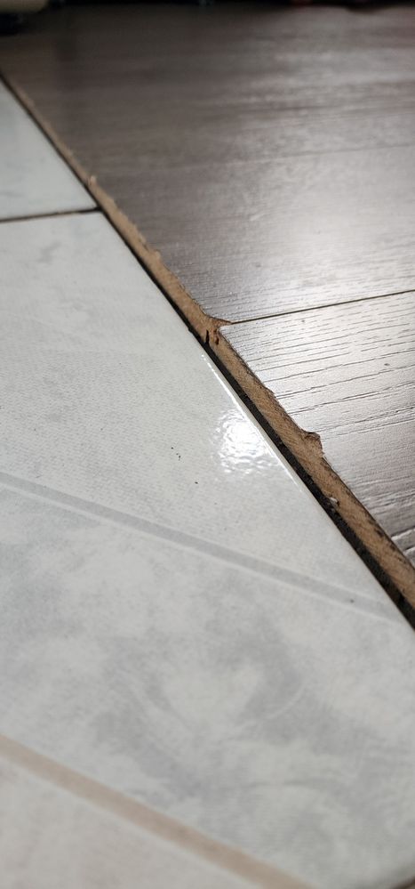

Hi guys, just looking for some advice on what to do and what to use with this transition strip? From the tile to the floorboard is approx. 4mm.
Any advice would help.

It's tough to tell from your photos. Is there a difference in height between the tile and the floating floor?
If there is no variation in height, you could use a QEP 25mm x 1m Transition Cover Trim, fixed in place with some Liquid Nails.
If there is variation in height, you would need to use something like this Roberts Floating Floor Senior Trim. To use this trim, you would need to widen the gap by trimming the floorboards, as there would need to be space to install these Roberts Ramp And Cover Trim Plugs.
Let me know what you think.

Yes, there is a difference of 4mm from top of floating floor to the top of the tile. I think I will give the Roberts Trim a go!!!
