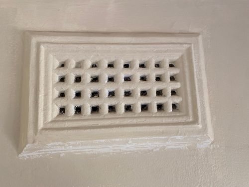

  • Multiple coats of paint on the ceiling rose, vents and cornices.
    I tried sanding it back and scrap the paint off the ceiling rose, but it does not seem to be effective.
    Thick layers of paint is obstructing the clean straight lines of the cornices.Thick layers of paint is obstructing the clean straight lines of the cornices.

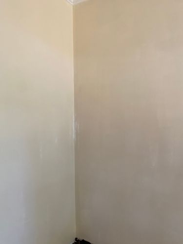

  • Corners of the walls are not straight.
    Tried sanding itl with an angled sponge sander and a block sander, and I seemed to have created a "curved" at the corner of the wall.

The air vents and their coats of paint. 😕 yeah I can see the thickness of paint. I have seen "how to" videos of people cutting them out and then working on them (so the fine mesh behind teh course checkerboard) is restored. Depending on how far you want to go its back to hand sanding and lots of patience with a small wire... ugh (My bathroom air vents are the same and yeah I have pondered over how I would approach theat as well)

With thick layers of paint on cornices, roses, and vents, sanding alone is often frustrating and slow, especially if the paint has hardened over many years. Careful hand sanding is still the safest approach, as power sanding can quickly chew into the softer plaster underneath and make things worse. In many cases, the goal is to reduce the visual build up rather than completely remove it. Trying to chase perfection here can easily lead to more damage than improvement.

Wall corners in older homes are rarely straight. Once you start sanding them aggressively, it’s very easy to create that rounded effect you’ve noticed. At this point, I’d suggest stopping further sanding on corners and instead focus on making them consistent rather than perfectly straight. Minor imperfections tend to disappear once painted, especially in softer or matte finishes.
