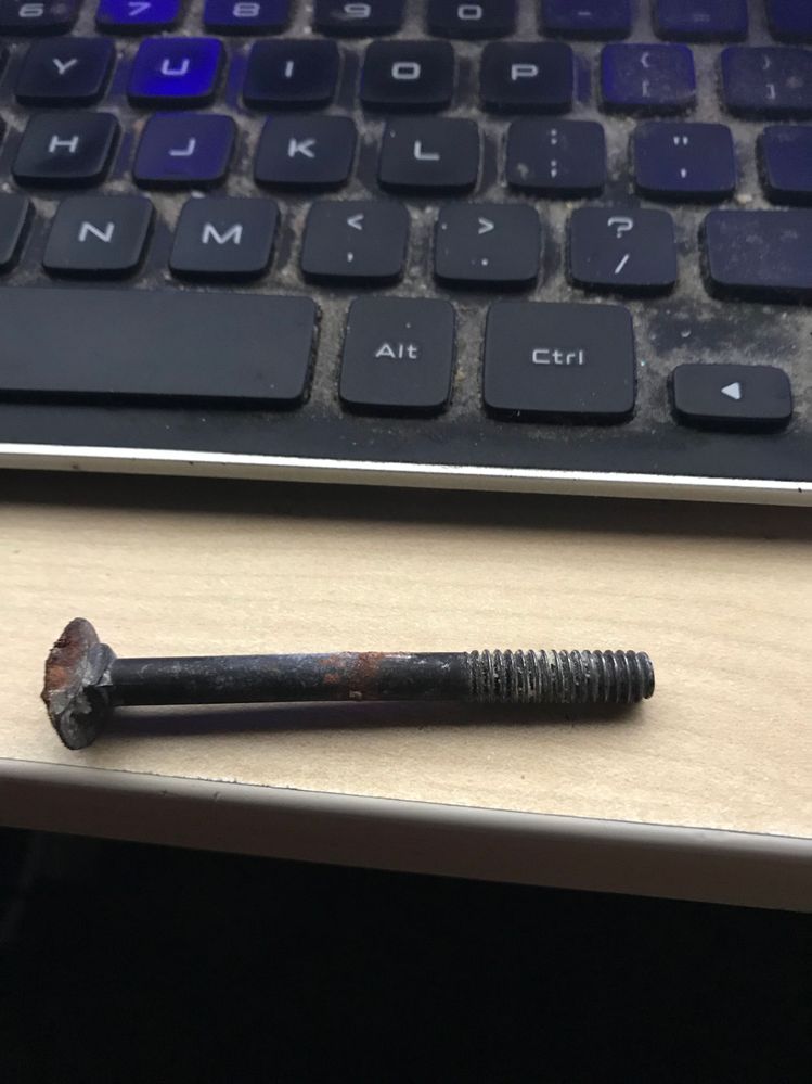

Hey @Brad - in the first picture, those are not bolts - they are a form of “nail”, with some sort of rough cut “washer” underneath. Are those fixed into the TOP of the mantle piece? I think you said the work dated back to 1955 (Grandad), but this is not a new build at that time, this looks like an older home that was modified in the 1950s.

Definitely bolts looks like carriage bolts that had the heads ground down to fit a spanner.

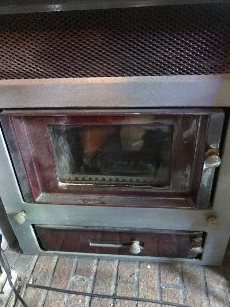

Including a pic of the offending combustion heater.

WOW, don’t those bolts look a whole lot different in close-up. In the original photo they looked like nails for horseshoes. I’d get the angle grinder out and cut them off, see if the mantle piece will lift off from them - it looks like they’re the only fixings ![]()
