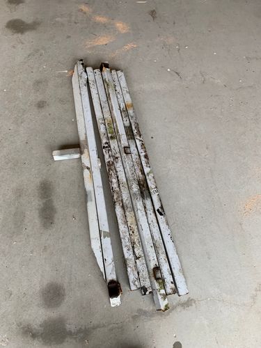

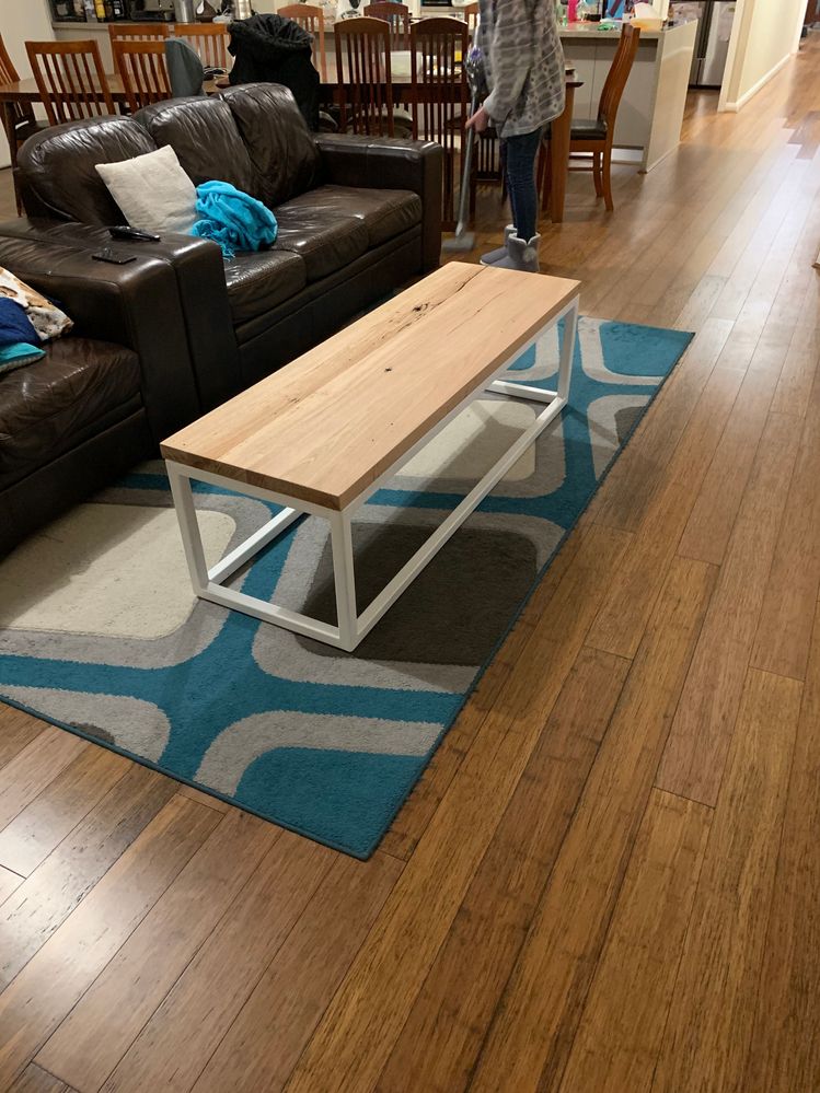

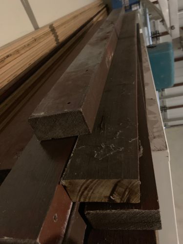

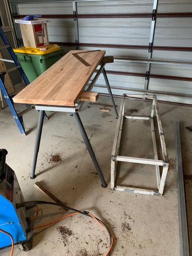

I turned a couple of piles of old material into a coffee table.
50 year old bed posts50 year old bed posts20 year old steel20 year old steelTable machined and joinedTable machined and joinedTest fitTest fit
