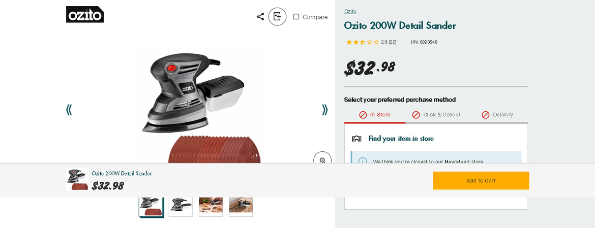

Welocme to Bunnings Workshop and thank you for sharing your query with us. I'm in agreement with @MitchellMc's recommendation for the product to use. But I also find this as a great excuse to buy a new tool! If you are sanding more than 1 window it would be convenient to have a detail sander such as the corded Ozito 200 watt detail sander. I prefer this starter tool as it comes with 20 free pads in the kit! You can pretty much sand all the windows in the house with this little unit. Not only that, if you ever decide to take the next step and refurbish small tables and chairs, that detail sander is perfect for the job. But if its just the one window then a nice sanding block ought to do the job neat. Please keep us informed of your progress so that our members will benefit from your experience!

Thanks! I should really do a few windows, so I think grabbing one of these sanders might be ideal.
