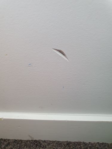

Hi Everyone, I need some advice. I have some really small holes or dents in the wall from toys hitting the wall by my toddlers. What is the best product to use to fill these back in? Need something that is super simple and fast at drying.

plaster of paris mix (in a pinch) and a small trowel to put it on, once its dried you will probably want a sanding block to sand it flat again. I got so many dents etc here I just buy bulk bog pre mix lol

I should follow their advice and purchase something of a larger quantity, as I have plenty of those dents around my home. I normally pick up a premixed container of Selleys 180g Spakfilla Rapid Gap Filler. They come with a convenient little application spatula used to push the filler into the gap. Once the filler has dried, sand it back smooth with the surrounding plaster using 120-grit sandpaper and a sanding block. When you've finished sanding, apply some British Paints 100ml White Prep 4 In 1 Water Based Primer Sealer Undercoat and then topcoat with a low sheen interior paint.
