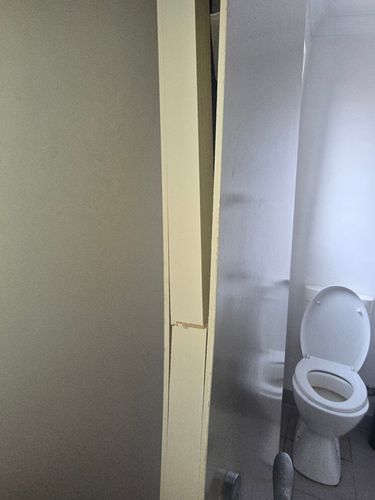

Hi all,
Looking for advice to see if this is fixable or has to be completely replaced. Wardrobe   Door come off the hinges, fell and hit the edge of the bed.

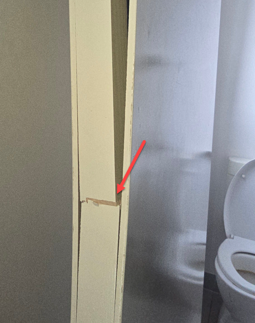

Unfortunately, I would say this needs to be replaced. The main reason for this is that the timber frame that runs around the perimeter of the door has snapped along a finger joint in the timber. If this frame were intact, I would say it is repairable, but because of this, replacement is your best option.
You might like to consider using our Door Installation service to replace your damaged door.
