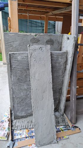

How to make waterproof my concrete water fountain. Please suggest the best painting options?

Welcome to the Bunnings Workshop community @Jom010. It's wonderful to have you join us, and many thanks for your question about waterproofing a fountain.
Once you've formed up the bottom of the fountain and attached all the sides together, you'll be able to paint the surfaces with Crommelins Pond Sealer. It's UV stable, comes in a variety of colours and is suitable for masonry surfaces. In the corner between the panels, you might like to use the sealer in combination with reinforcement fabric to ensure there are no gaps and that the corners are adequately sealed.
Please let me know if you have any questions. We're here to assist.
