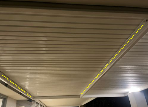

trying to upload a photo again, not sure why it didn’t go through. I would add some joists/batten, but that is the patio

Your correct, these would add significant weight and need extensive additional timbers (in my case) to fix to, which add another layer of complexity to the build. See image below. This project was the early stages of essentially enclosing much of the rear deck to maker it a useable space in winter and add my privacy for a twin-occupied property.
What I think would look great that would be an easy install and light would be these 42mm x 18mm white coated battens. Spaced say 10-15mm apart would work nicely with the white backdrop of the white Stratco roof. They are also relatively cheap at $5.30/Lm
I would install a couple of smart home LED light strips to the Stratco beams facing each other. This would produce a controllable light source from a gentle glow to more usable light.

Having a look at the photo you've uploaded, to install panels, you would need to add some fairly significant framing, which in turn adds weight. If you wanted to go ahead with the project, you would have to confirm with the manufacturer of your patio what they are happy with. The main thing is that everything needs to be safe.
Those lightweight inBuilt 2700 x 42 x 18mm Battens that @Nailbag mentioned look like something you could consider. I would still be checking with the manufacturer before installing them, but they would certainly be more manageable than a VJ panel or acoustic panel.

I’ve contacted the manufacturer to see what they say about weight or recommended products. I love the LED strips which will work great with with what I am thinking. After looking through Bunnings website the HardieFlex boards are the lightest I could find, a 2400x1200 is about 10kg. I might place them with a 10mm gap in between them and add the LED.
