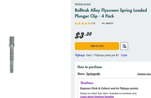

I often use Flyscreen Spring Loaded Plunger Pins
For fiddly flyscreen jobs.
