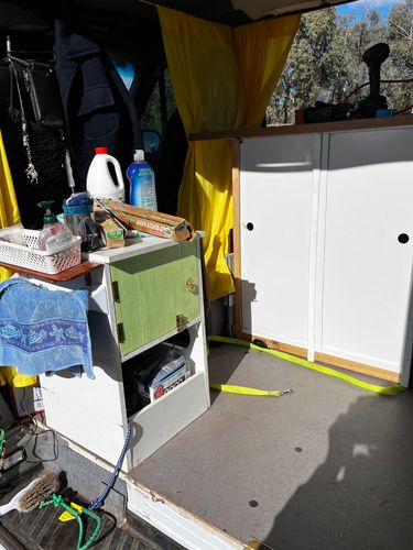

single. No money. So fitted out my whole van from Forbes Bunnings off cut box .  Only cost was fittings and screws , glue.  Total cost of whole project  , minus bedding etc about $150.   .  Now traveled Australia  near and far. Having great fun with my dog . Works perfectly .  Use a canister gas stove , and now frying pan, for cooking when not on power.  Have an 12 volt rechargeable shower head and collapsing bucket for shower.  A rubber Bunnings’s mat on ground . I put a curtain between my two back doors for shower . Also have a Bunnings DVD player and small TV when a reception available.  Couldn’t afford a professional fit out , so I did this myself as I found suitable off cuts  to add in more.  Oh and paint used was a “wrong” mix paint
Materials
scrap/ off cuts from off cut box. ( free) hinges, latches, screws, nails glue .    I used my very old trusty Makita tools
Tools
Steps
Step 1

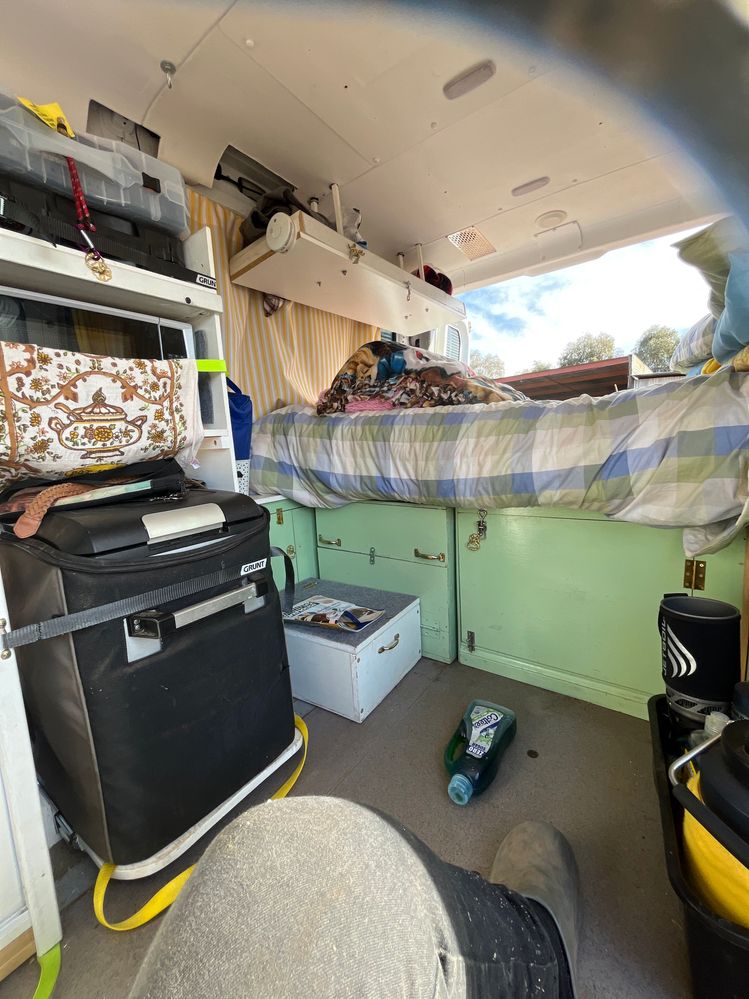

Raid the off cut box every time I went to Bunnings in Forbes.  Started with a “ box “ type set up for the bed. Then added a “box” which slides out , lift up lid in front of original box and a cupboard to make bed bigger ( queen) and add more storage , white board off cuts and chip board off cuts used, and or cover boards,   hinges , screws, latches, only things I needed to buy  .added on more cupboards as I found suitable off cuts. Now have “ kitchen “ cupboard and a cupboard over battery box.  Fold up table made from off cuts used and old fold up stool.  Battery box also acts as a seat .  Love it all. Oh and my trusty old Makita tools.

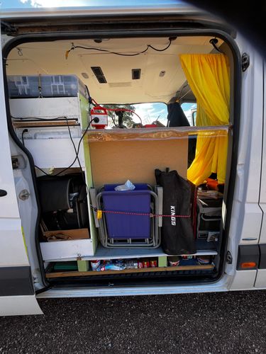

  filled in the step area on drivers side for more storage and it provides a space for folding  table and chairs.  Bungie straps very handy

 my “ seat “ when raining , toiletries cupboard over battery box also . I have tried to keep floor space at max as I use this van also for my farm shopping , it’s my only vehicle .

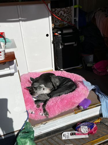

 happy dog also. Plenty of room for her
