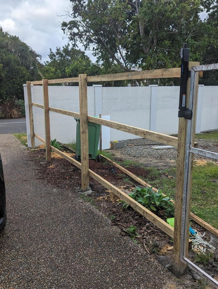

Hi MItchell,
Thanks for the advice, really appreciate it. I will post photos after its built. What do you suggest using to cover up clouts. I am thinking to attach a piece of wood batten (thin one - 10 or 20mm thin and 75mm wide) on top of panel. Specially from the other side where it will be flush. I am going to install panel on both side as you suggested earlier and then painting it. As you can see from the pic, I just finished installing modular wall on the front. I didn't go for modular on this side as I may remove this fence in future so didn't want to spend too much. Also, this fence is my pool fence as well.
Re: Can you use fibre cement sheeting for a fence?
Hello @mehulnnaik
It's definitely an idea worth considering; However, I suggest using 42 x 11mm 5.4m H3 Treated Pine FJ DAR Primed LOSP as an alternative, as it is pre-painted with a genuine pink primer, and H3 treated against fungal and insect attack. Just keep in mind that the timber you'll should be rated for outdoor use.
Another option is using Parfix 500g Ready To Use Multipurpose Filler to cover the nail heads, it is a versatile, ready mixed filler ideal for filling cracks, holes and gaps inside and outside the home. It can be sanded down and painted over with your preferred paint product.
