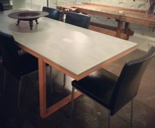

Making an outdoor table for a large, covered and sheltered deck.
Would like a concrete look finish and have seen examples using fibre cement sheeting.
Looking for advice for how to finish/seal the fibre cement sheets that would give a clear gloss finish whilst maintaining the cement sheet look.
See pic for example

Hello @Manley
Thank you for sharing your question about putting on a clear gloss finish on top of the Fibre cement sheeting.
I recommend using the Crommelin 4L Gloss DiamondCoat Paving And Concrete Sealer. It is one of the most common sealers used on pathways, pavers, and cement walkways. However, you would need to find out if there were other steps taken before the sealer was placed on top of the fibre cement. If the sealer is placed on top of the Fibre cement sheeting as is, it will seal it. But it will not give you a flawless flat surface. This is because the Fibre cement sheet itself is not finished perfectly flat.
There are a few finishes to choose from in the Crommelin Sealing system. I suggest visiting your local store and seeing if one of them is to your liking. This sounds like a fantastic outdoor project. Any updates you can provide while building it would be much appreciated.
Let me tag our experienced members @TedBear and @Brad for their recommendations.

@Manley
I would look at a primer first then the sealing topcoat. Liquidstone range have a clear primer and clear top coat.
One of the 2 part epoxies may give a smoother finish with a higher gloss, it is just an educated guess though.
