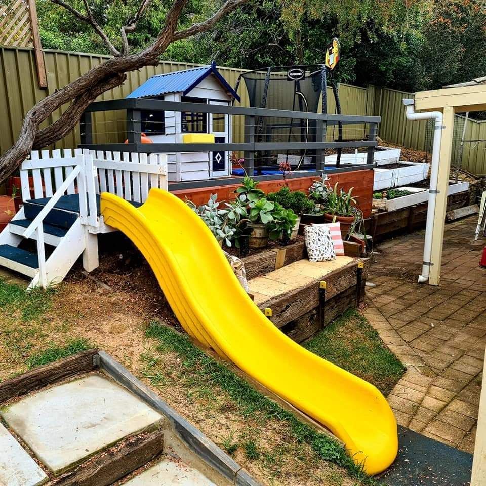

We moved in into our first home which was on a hill with no flat area to play. Flattening the rear yard was out of the budget so I came up with a way we could use the space wisely to achieve an entertaining play area for us and our children to enjoy. 1.5 years in the making, working on it most weekends and a few nights a week shoveling in the dark after work while only using hand tool as we couldn't get any machinery in, we now have a fun multi purpose entraining area. All materials were second hand, free or upcycled. The whole backyard was under 5K.

First step was removing all the trees and the concrete BBQ to see what I was working with. The lawn areas was made first so we had something to start enjoying and made it less muddy during winter.
Step 2
From there I measured up the deck area to a height and length we could still watch from the loungeroom window as well as measuring how many decking pallets I would need.
Step 3
From there I resourced all the pallets, treated post, cubby, slide etc from marketplace, or give aways until I had all the items to start building.  The cubby was transformed and painted and the pallets were all screwed together in sections ready to screw to the posts.
Step 4
22 concreted treated posts hold the deck up in sections all bolted together and stained to protect the wood. From there the trampoline and cubby was lifted up ready for the railing.
Step 5
We then install the railing posts and safety wire to protect the kids from falling over.  Then it was time to enjoy.

Thanks mate. It was definitely a challenge. Having an idea on paper is one thing, actually constructing it was another. The lawn area was done on the fly with just a mental vision, and the deck area was constructed as we went based on a drawing with no real dimension guide. That’s what D.I.Y is right. I had absolutely no knowledge on structure reinforcement or legal rail requirements before this, so a lot of research was done as we went. The hardest part was digging the holes getting every post level in rock hard clay so the pallets could slide over the top in the correct spot.  (thank god for string line and long timber beams). The other hard part was getting under each section to bolt the decking pallets to the posts. There was not much room on the left side. The deck is joined together in 3 double sections with timber reinforced beams through the pallets holding them together, so lining it all up under neither to bolt up was frustrating.
The front is also in sections so if I need to get underneath, I just remove one pallet section. The built in trampoline is also removable so once our little ones grow out of it I can detach and replace with full pallets to now have an adult BBQ entertaining area. We’ve had 5 adults and 6 kids up there with no issues or movement.
Would I do this again?  Absolutely, though I would make the structure more simple like a traditional deck with frame and decking boards. Being unknow ledged I thought joining pallets and putting them on posts would be easy. That was not the case.
