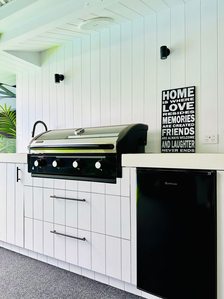

Hi @balaymiDIYreno,
It looks like a fantastic place to create succulent meals to share with your family and friends.

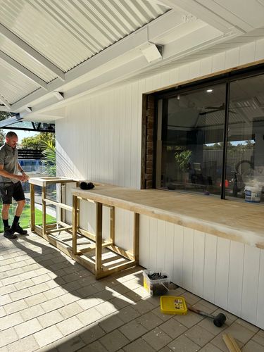

If you have any details of the process or photos from the build that you can share, I'm sure our members would love to see them.
Thank you for sharing your D.I.Y. outdoor BBQ.
This is stunning. Would you mind sharing your products and process?
Thank you.

Let me tag @balaymiDIYreno to make them aware of your kind words and questions. It is quite a stunning outdoor barbecue area. I am curious as well as to know what materials were used for the cabinetry framing and what kind of benchtop was placed on top for the entire setup.

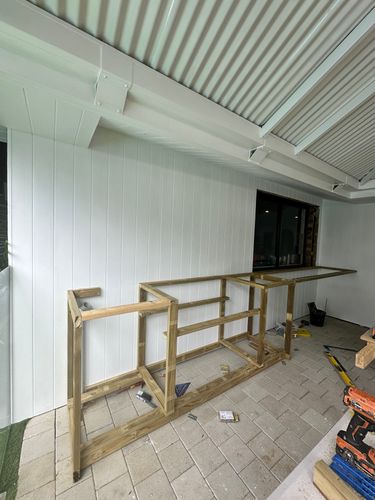

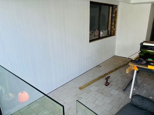

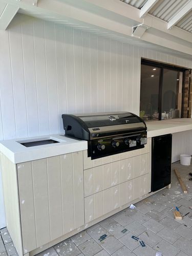

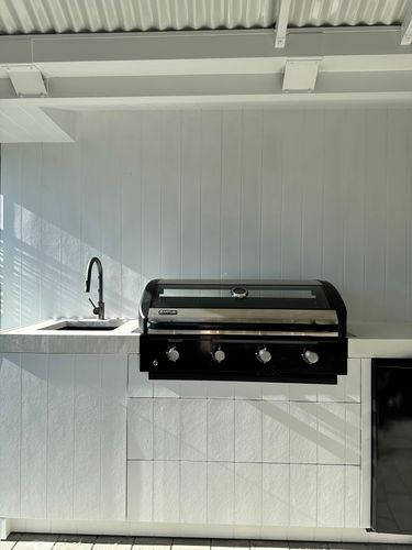

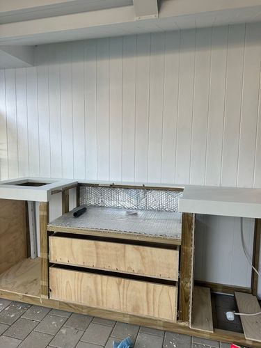

Hello all! Thanks for the love. Sorry we have been busy with work. Hubby used treated pine for framing, James Hardie Axon cladding for the cabinets and drawers, Dulux Microcement for the benchtop. I will share some photos of build.

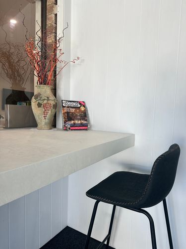

Thank you so much. May I ask how difficult the micro cement process was and how it is holding up to use and heat?
Your kitchen is gorgeous.
Hello! its been almost a year in use and no issues so far with it but the process of applying microcement is intense- mixing it properly, applying it, trowelling, curing for days, a lot of careful steps involved for it to be a proper microcement. My hubby did a full day course of microcement application just to be sure. We also used it on our new laundry, bathroom floor, etc
