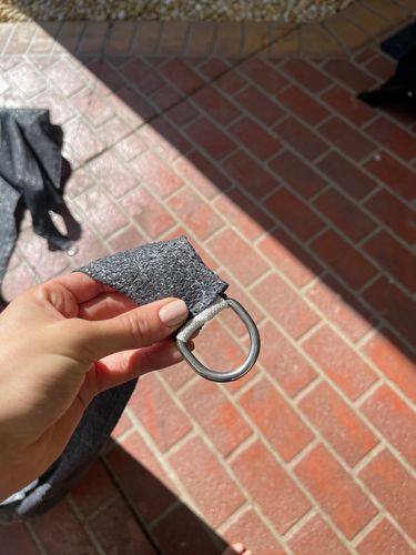

I want to place my shade sails off my pergola as the sun hits most of the afternoon and we are unable to sit under the pergola. What is a solution that I can hook the sails on and off, so that I don’t have to have the sails on the whole time? It will need to be attached to my pergola and then I’m thinking to the brick wall, and somehow to the cubby house. I have 2 huge sails, one triangle in shape and the other a square. Your help is greatly appreciated.

thank you so much for your help. I am really only needing the sails for when I have events at home which is about 3 a year, and they are mostly around Oct/Nov time so no wind, which is why I don’t want to go through all the trouble of posts. The sails will not be going up if there is any wind. I have just watched the linked video on installing sails, the anchor/eyelets that they use to install on the posts, would that be okay to put on my pergola? And then I saw you guys have shade sail kits like the strap tension.. I think I need this because there won’t be enough sail for the distance (I hope that makes sense)
