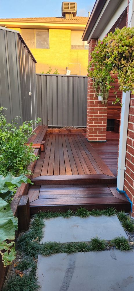

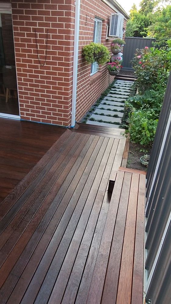

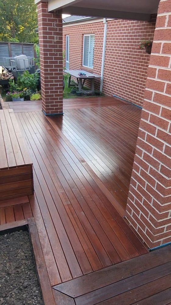

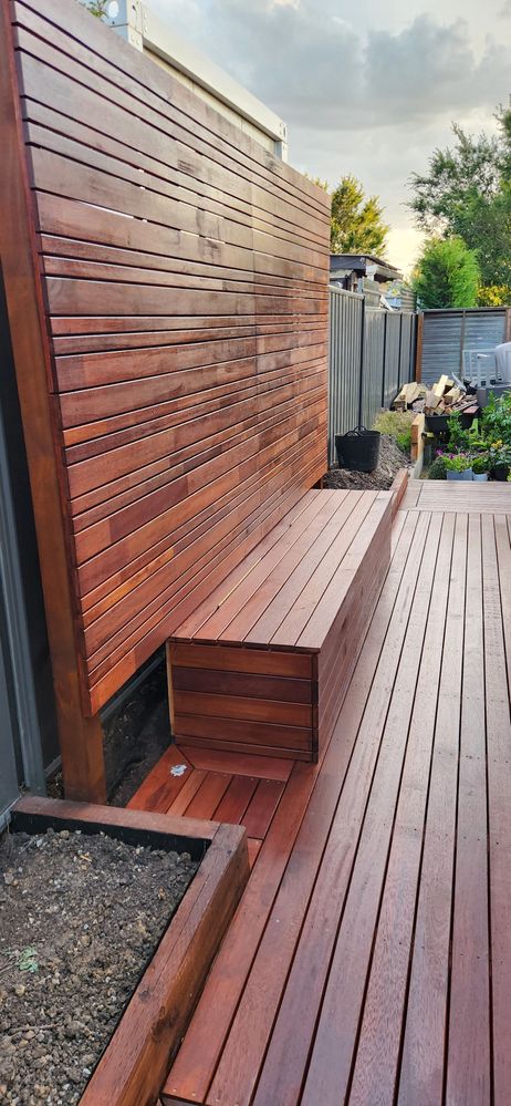

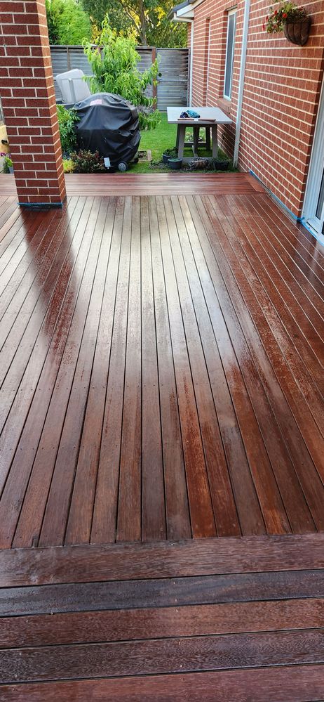

quite satisfied of the final result, very happy with the blending of the old and new and the level of gloss and colour is on point!

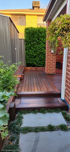

the last step now is to get rid of the old dirt and replace with some quality soil and plant my hedging plants, I'm considering viburnum quick hedge for its growth habits, it's designed to grow only a little bit higher than what i need so maintenance should be hassle free, i love the leaf and the colour, and hopefully leaf drop is kept to a minimum. in the spaces either side of the seat i would like to put two ficus, cut topiary style. for the time being i'm just scouring marketplace for the right one to show up! i'll post an update in due time, might be a little tricky with Xmas around the corner but one can hope!
Here I just used the help of ChatGPT and some photo editing to visualise the hedge fully grown, I think it will look great! 
