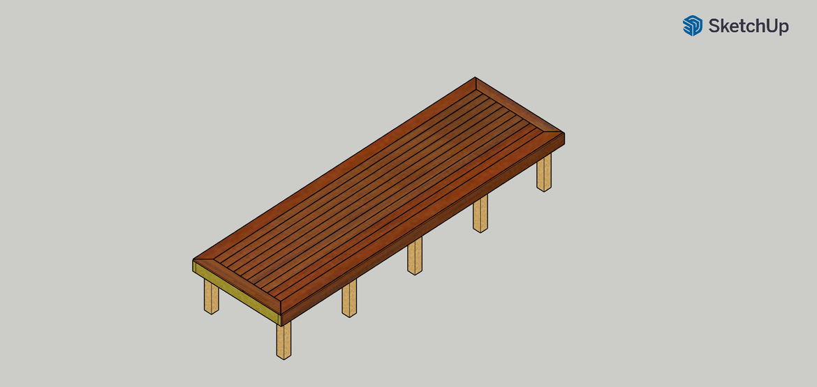

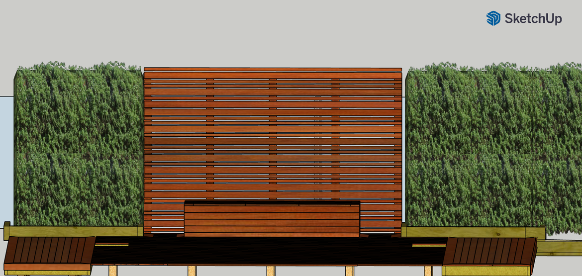

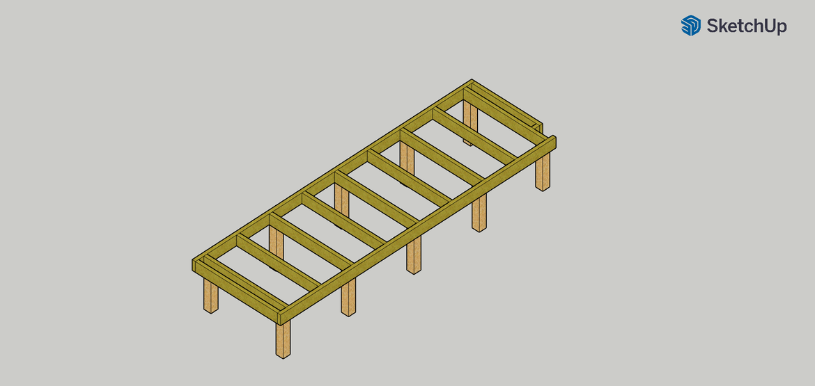

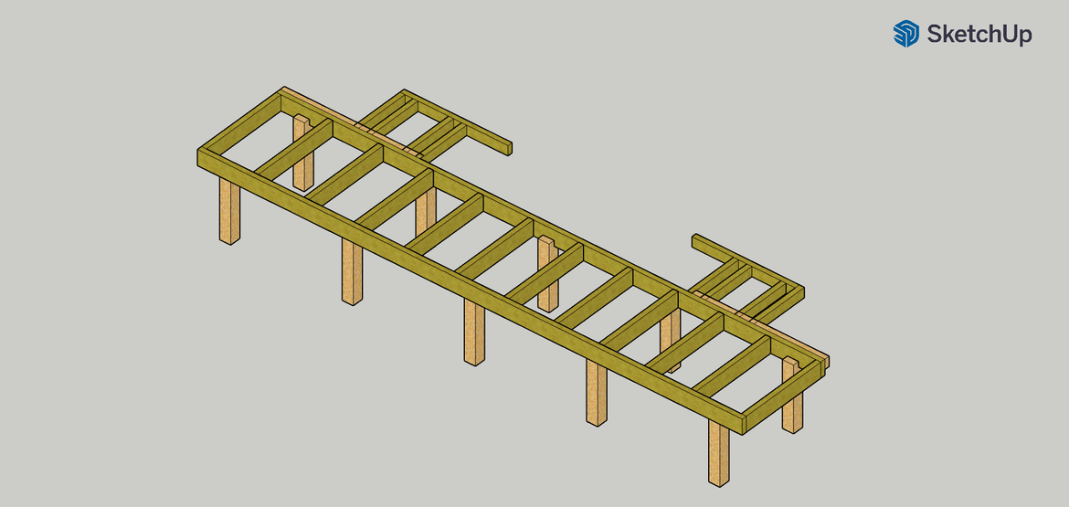

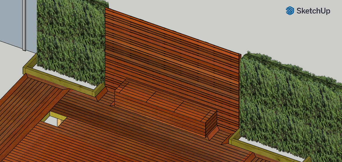

the design shows the alfresco and the house, and all the completed decking, with seat and privacy screen from a few different angles and how i intend to use it as storage, with 3 panels on hinges.

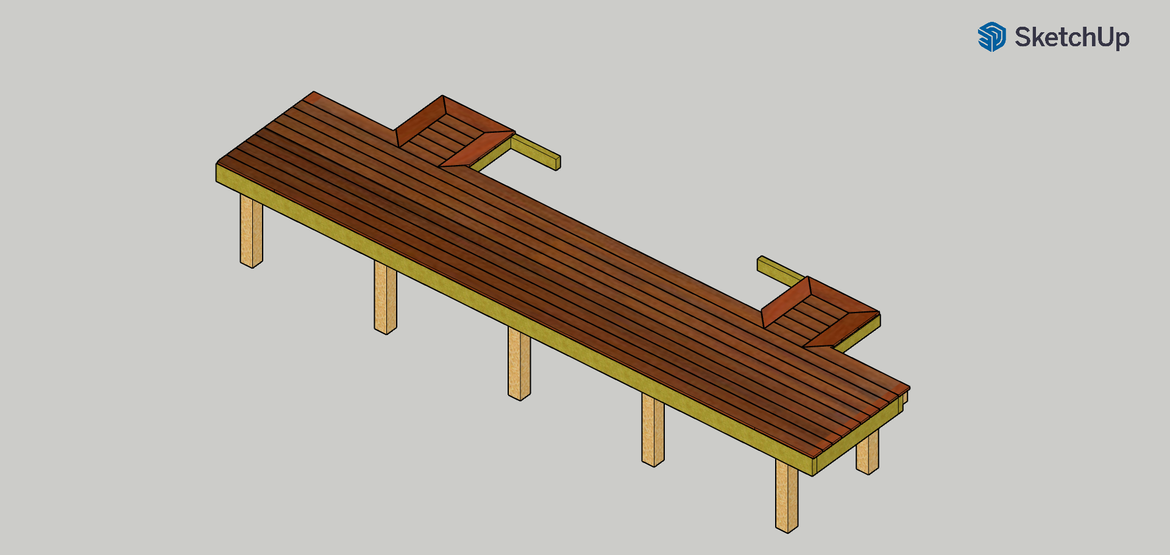

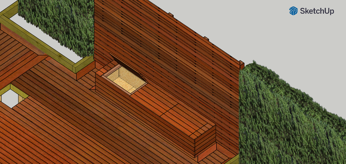

The following shows each part of the project, and the intended frame design. the privacy screen will be the specrite screen panels x4 as seen in this image from bunnings:
https://www.bunnings.com.au/specrite-1800-x-902mm-pre-oiled-merbau-alternating-slat-fence-panel_p850...
 this will save me some time and cost along the way

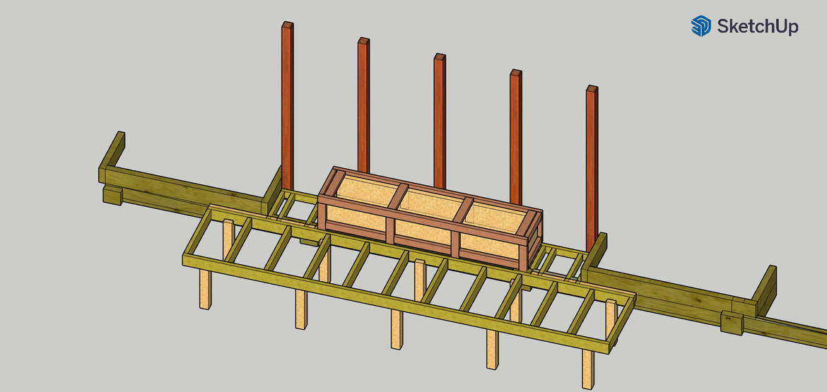

the deck supports will be 100x100 H4 treated pine,
deck frame will be 140x45 treated pine and merbau decking, with merbau seat.
the screen will be supported by 100x100 cypress posts (DAR) which I'll stain with merbau stain and the seat/storage box will be 90x45 treated pine lined with plywood for the inside to stop any spiders and protect the storage contents from the elements.

the framing up was easy, went up pretty quickly and not much messing around, although it might be hard to see but in the second image I secured a 90x45 to every joist with bugle screws, which meant I had to lift up 3 decking boards to access the frame, this allowed me to completely avoid needing any posts, i ran these 300mm under the alfresco deck to support the deck, and to maintain the line where the decking was attached, i just extended the joists and bugle screwed them to the tie-in joists, great for rigidity! and the other end i installed waling plats along the 75x200 garden bed and screwed it all down making sure the level was perfect
