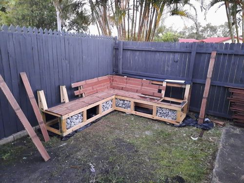

Hi team
Looking to build some bench seats for a fire pit area and like the look of loose rocks under the seat. Similar to the pic below but with a back rest on the bench.
Also I will be framing out the bench with treated pine and cladding in deck boards. I only want the rocks at the front as a decorative thing so won't need a large volume of rocks to fill a full Gabion cage (actually thinking of cutting down some steel fencing to use as the mesh).
Any suggestions on where I can buy rocks like these? Do @Bunnings sell them? Or would I need to visit a local landscape supplier? Gabion rocks.PNG

I didn't actually take a lot of photos during constructions which is unlike me! Frame is built from H3 treated pine, screwed together. The deck boards are from the reclamation yard, not sure of the species but some kind of red Australian hardwood.
The cage is a simple box construction, with some wire "u-nailed" to the front and then the rocks dropped in from above before I clad with the deck boards.
Any other questions please shout
