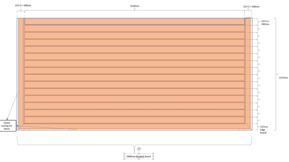

Based on my calculations, the decking boards will be about 5120mm laid as shown below, which including the framing would make the 5.4m deck im intending to build. This will be built on 2x5 1113 x 1113mm good time frames. I will have to cut the right most frames down to fit.
1) Do i need to factor in a breaker board for a 5.12m length of ekodeck or is it fine to go with the one length as designed below?
2) If so, i guess i will need to add extra joists in the middle and both ends?
3) Does the design look sound? I didnt add support points as good times decking has guidance on that.

Hello @snipwhip
Since your deck panel is only 5.1m long and is surrounded with a picture frame it technically falls under Ekodecks recommendation of a breaker board if your deck is past 5.4 meters. That said, if you decide to add a breaker board (for visual symmetry or thermal management), then yes, you’ll need double joists on both sides of the breaker board. This allows you to fasten both the board ends and the breaker board itself. You’ll also need double joists along the outer edges (which Good Times frames usually already support). In your case, the two 1113 × 1113mm frames would require an additional joist line down the middle if a breaker board runs lengthwise.
Your design is sound without a breaker board, provided expansion gaps are properly handled. Adding a breaker board is optional for aesthetics or to simplify expansion management but would require a few more joists and fixings.
