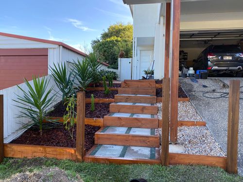

Relatively steep slope, was difficult to mow lawn. Had quotes for concrete steps which were astronomical.
I decided to try my hand at steps and the project evolved from there. Used 75mm sienna sleepers from Bunnings for longevity and strength.

I measured the slope and worked on the basis of 200mm sleepers as the height of each tread. Each step has approximately the same depth, so a formula was followed. The last step only has a height of 100mm as it needed to butt up against the concrete platform. That sleeper was attached to the concrete by 8mm masonry bolts.

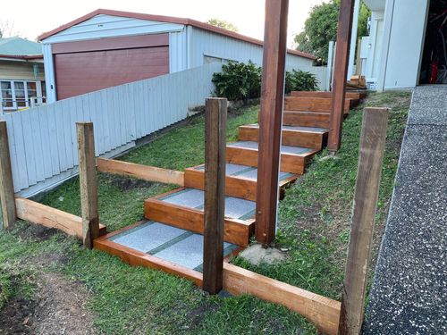

I dug each step out and worked from the bottom up, anchoring each step with 10mm steel rio to a depth of 400mm. I built each step directly onto the ground without pre-assembly. The steps were then filled and compacted with crusher dust and granite pavers. No concrete was used at all.
The whole project was finished off with Cabots Aquadeck.

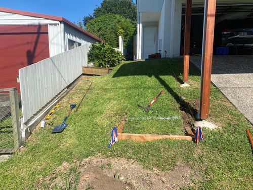

Your steps look amazing! It looks like you made a series of 'U' shapes from timber. Did you level the first one off, then lay the next 'U' towards the back of the first, then cut out the dirt around to level it off and then work your way up?

Let me tag @bthederan to make sure they are aware of your kind words and questions. Looking at the progression of the photos, it looks like they started off with the bottom step and worked their way up to the concrete walkway. My best suggestion is to use a builder's line so that you can properly estimate the angle of the stairs.
