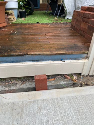

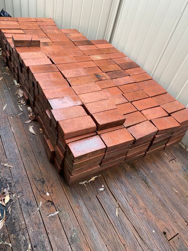

Here is a photo of the pavers and the back door where they will be layed. The height from the back door to the ground level is about the height of two pavers standing long ways.

Assuming the ground beneath the deck is approximately level, then I'd say your estimated step down of around 500mm would be pretty close. When you can get to the ground directly beneath the door, you might even find that 2 steps with rises around 166mm high would be enough.
How far in the future are you planning on removing the deck?
I'd be happy to assist along the way.

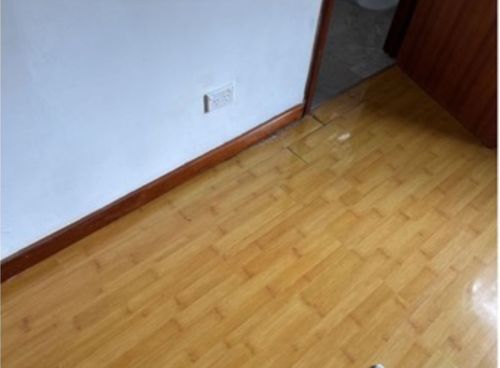

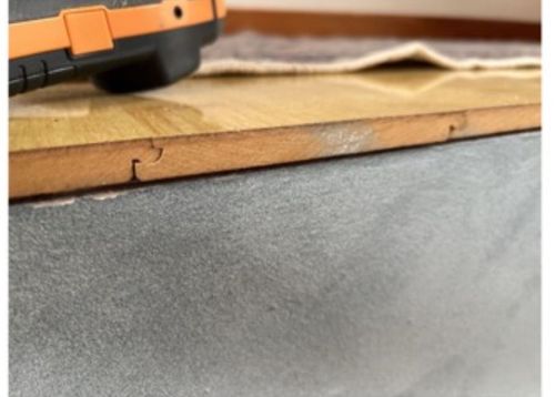

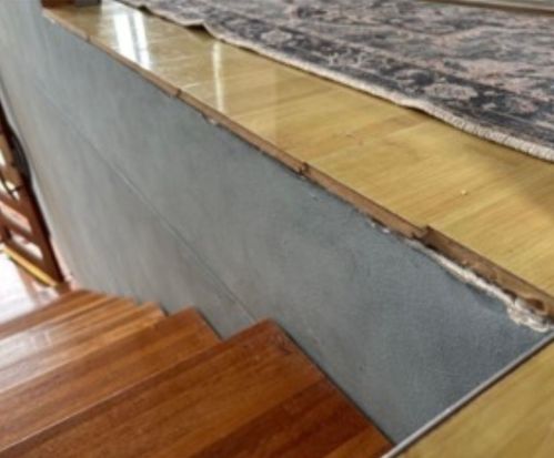

Jacob I have another question. Can you please tell me if the flooring I have is laminate with underlay or a hybrid type of bamboo flooring?
