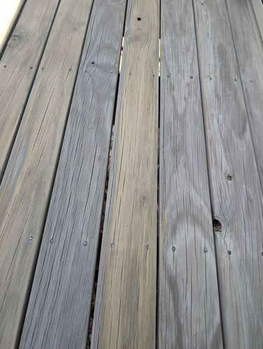

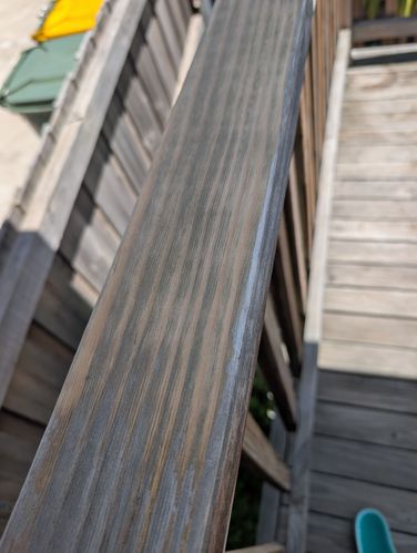

Today I made a start on sanding the deck (I didn't get very far as I started late and now the sun has come around on a 27° day.
I will use the midday heat to go back to Bunnings and buy stuff to sink the screws, which I forgot yesterday..
I wanted to share a couple of pictures of what I have done so far (you can where I had to skip as the nails were sticking out too far). I have been using 80 grit sandpaper. I do understand about oiling, but I think I might paint (I am liking the pale eucalypt colour :smile: ). I wondered please, after using the 80 grit, would I need to go over it with a finer, say 120, grit, or would the 80 be enough to make it smooth enough for the paint to stick?
