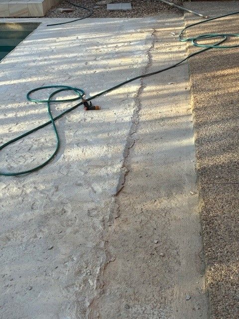

Hi Guys,
After i have primed i need to raise the level up a little behind where the tiles currently are. The new tiles will go back further and there is a little drop off. floor.jpgWill sand and cement mix adhere to the existing concrete or am i better using the leveller.?
Re: How to add a concrete layer before tiling?
How high is the little drop off @Markcub? If it's within the max application depth limits of the self-leveller you're using, then I'd suggest you level the area all in one go with it. Alternatively, you could use sand and cement to fill that area first, though it doesn't have any self-levelling properties, so you would need to ensure you level that area manually.

Hi Mitch,
The drop varies between 20 and 30mm.

Hi @Markcub,
The Lanko 20kg 173 Floor Leveller has a maximum application thickness of 25mm, so you might have to top up any of the lower spots with a repair mortar such as Dunlop Ardit Rapidset Repair Mortar, allow it to dry, paint it with your primer, then pour the self-levelling compound over the top.

Thanks Jacob,
So the repair mortar will stick to the existing concrete bed.?
