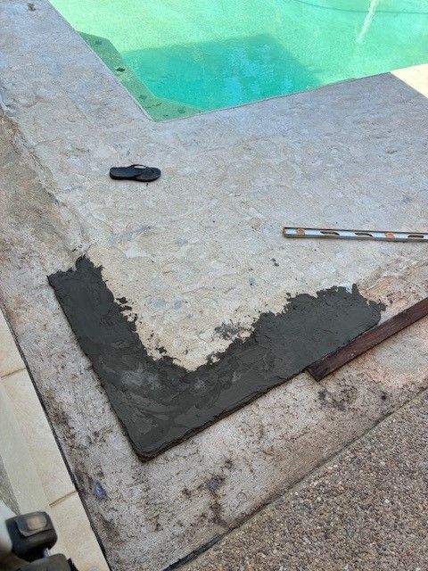

I want to pour a thin layer of concrete over existing concrete to raise it up prior to tiling it. How do i go about this.?
Re: How to add a concrete layer before tiling?
Hi @Markcub,
You can use the QEP Lash 360 1.5mm Levelling Clips with QEP Lash 360 Tile Levelling Caps for levelling of 20mm thick tiles.
It would be best to apply your primer to the whole surface, then add your mortar, allow it to dry, then prime over the top of it before adding the self-leveller. This will ensure you get the best bond between the repair mortar and the concrete, and then the leveller to both.

Hi Guys,
Do you have anything bigger and in regards to the repair mortar.? Below is 10kgs worth. It is shallower at the ends but i reckon i will need 10/15kgs more. I bought a 10kgs tub to start with.
Hi @Markcub,
You can use this Dunlop Construction Grout, you would just have to mix it.
You'll want it to be mixed relatively dry so that it can be built up where needed, so add water incrementally until you achieve a low-slump, packable mix.

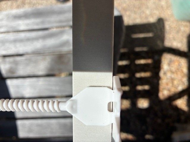

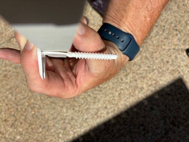

Hi Guys,
Justa note on the spacers you suggested, they actually catch right at the top on a 20mm tile so they are wider then 1.5mm. I made them work but i would say that the max would be 18mm not 20mm.
