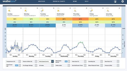

Thinking outside the box I am proposing a low cost backup system for 'peace of mind' when you are away.
I will assume the Awning is connected to a compatible bridge or hub on the home wi-fi network and therefore accessible from the Internet.
Purchase and setup a outdoor wi-fi camera to monitor the Awning area.
Use one of the weather channels.
Here is Weatherzone displaying wind speed with the rest of the data removed.
For the people I have helped that basic backup system is enhanced with various devices like servo actuators or linear actuators to remotely open/close gates/doors for example chickens and horses can access their sheltered areas (chook sheds/stables) if the weather suddenly turns nasty.
Even if you come up with what appears to be reliable operation I myself would still wonder and worry about what's happening back home - are those sensors jousting with each other? If needed I can provide info on how to remotely turn off those sensors so you are guaranteed manual control when away.
