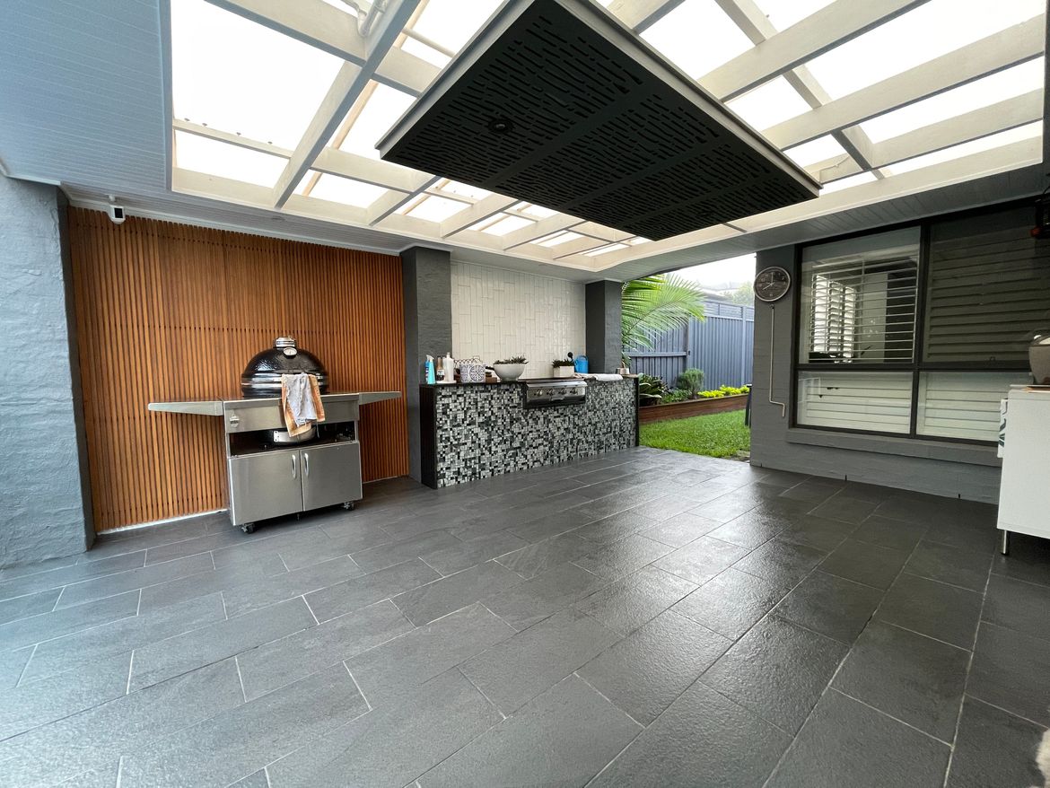

I previously had this at previous house with the 2 pics below but having wooden patio framing a lot simpler and looking for similar idea more modern etc cement sheeting / vj lining Hampton feel etc.

Outdoor table size 2.2mtr - 1mtr so ceiling fan centre and I can install seperate led down lights either end of table like I did in pics below also.

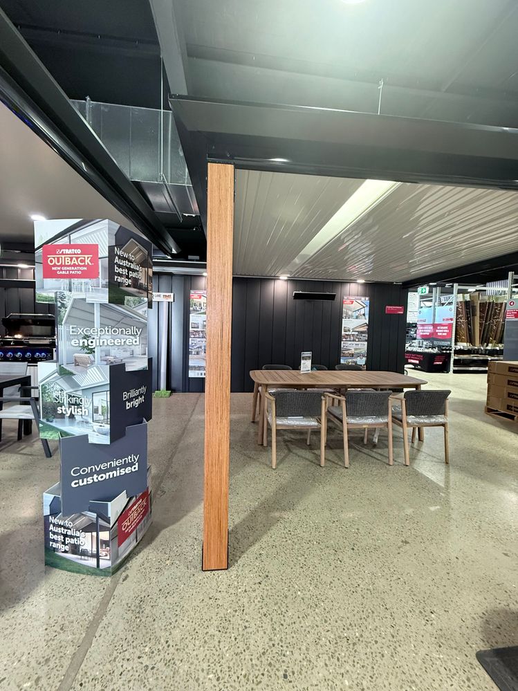

Demo
Demo but just 3 beams go across left, right and 1 centre

Here is the rough out as requested, noting the right of roof/building nothing will be placed as I have AC blocking it and I need light coming in. Less weight for that area/being supported by beams. Will probably place shade cloth later.
