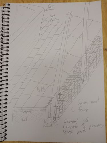

A sketch of my idea. The plan changed as in vertical to horizontal, mainly because of cost but also I have a lot of timber in that area and it felt a little too much.
Side profile showing how my posts will be installed. I didnt want to add weight to the fencelinbe so went the route of a self support fence like you are thinking of. I havnt finsihed the project, tho all posts are in at the moment. I just need to get some horizontal slats for the top 600mm.
