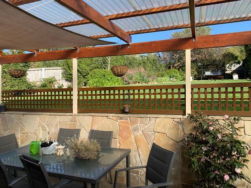

we are wanting to put strip lights (preferably electric) under our back patio running under the top rail of lattice (see included photos ).
We have choice of 2 electrical outlets which are both under cover of pergola and all wires will run under the roof
we cannot find any strip lights that have a long power lead.
1) what strip lights would you recommend (we need either x2 5M or 10 m)
2) are there
extension cords that can connect to the cords on the strip lights (we would need about 8 m if running a 10 metre single strip or 2 metre cords if running two 5 M strip lights

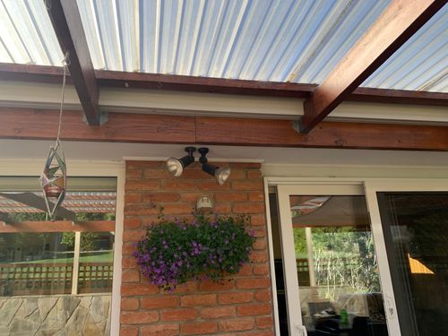

Thank you. As per the photo we already have a weather proof power outlet installed.
Re: How to add strip lighting to back patio?
Hello @bbam42000
My apologies that plug was very well hidden and blended in with your plant display. After searching further, the only other LED that has an outdoor weather rating is the Mirabella 4m RGB Genio Wi-Fi Smart Pixel Neon Flex Strip Light.
