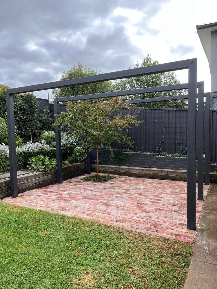

Project was our small backyard which when we moved in wasn’t an inviting place to be. We wanted it to be somewhere we could relax in afternoons as a family. We replaced the back fence, painted the retaining wall, replanted the garden beds and most recently, dug up a portion of the lawn and replaced with recycled red brick pavers. Surrounding the space with metal arbors we hope to now grow wisteria up and over.

1. Replaced back fence
2. painted retaining walls
3. replanted garden beds
4. dug up portion of lawn
5. Welded and installed metal arbors
6. laid foundations for paving
7. completed paving.

Stunning area, can I ask where are the pavers from? They are just perfect.

Thanks for sharing @jordanandrea. Can you advise materials you used for arbor. Many thanks KSJ

From the images, it appears that this might be a prefabricated steel arbour, rather than something they built themselves. I'm not aware of any similar products I could recommend.

Hi @shunt . These are recycled red bricks, which most were left over from our recent house renovation. They came up well as we cleaned these with hydrochloric acid and then swept off white coloured cement and sand between the cracks. If you are looking for some, I recommend searching for 'B grade recycled red bricks'.

Hi @KSJ. These arbour it is 125x125x4mm SHS. We sourced these from a local steel supplier and then welded and painted these with an undercoat and monument metal shield paint. Hope that helps.
