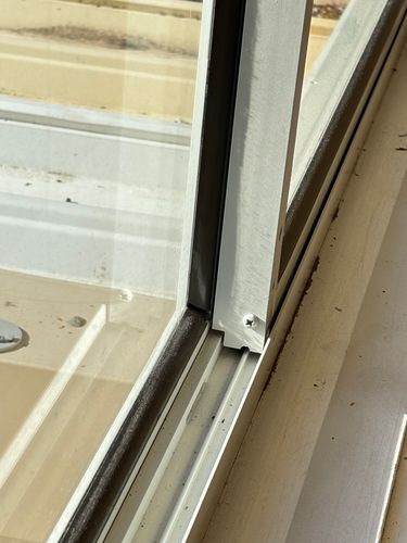

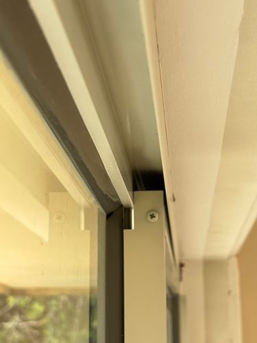

Just wondering how I would go about weatherproofing these sliding windows, I have tried the usual weatherproof self adhesive strips but they are too thick and don’t allow my window to slide. I had to take the original felts out to paint them but now they let a lot through.

They were felt strips held in on the window in a track. I am unable to replace them as the window would have to be pulled apart and we aren’t able to do that. Is there somewhere along the window that would be stationary for me to put the weather seals, or is there another way to seal them?
Re: Sliding Window Weatherstrips
I understand the difficulty @jorjmorris, but the problem is that removing the original felt strips has left you without the only type of seal that can reliably handle the sliding motion of your windows. Ordinary self-adhesive weatherstrips or foam seals will not cope with the constant sliding and are likely to peel off or fail over time.
If you cannot disassemble the window yourself, the safest and most effective option is to have a glazier reinstate the original seals. Most sliding windows allow the sashes to be lifted out of the bottom track, but it does require care, a second set of hands, and proper safety gear, including gloves, long sleeves and trousers, enclosed shoes, and safety glasses. A professional can ensure the correct felt or brush seal is installed, restoring proper weatherproofing.
For a temporary solution, you could look for very thin, low-friction seals that just fill the gap without being pushed by the moving sash, but these will not provide the same long-term performance as the original seals. Ultimately, reinstating the correct felt would be the most reliable fix.
