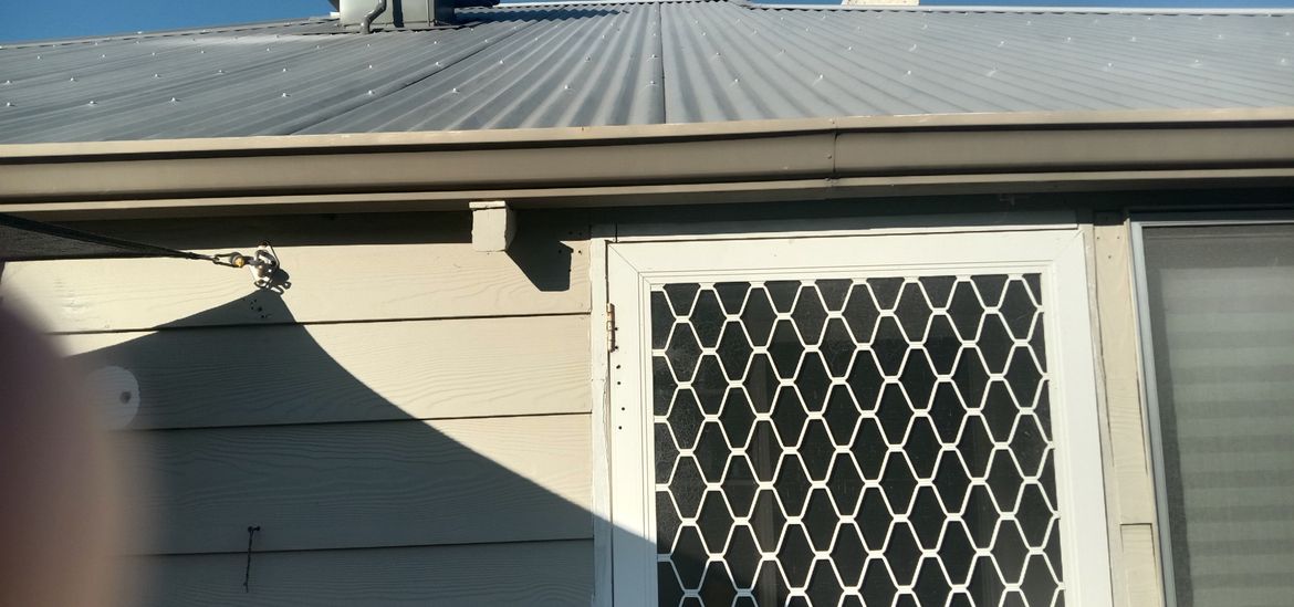

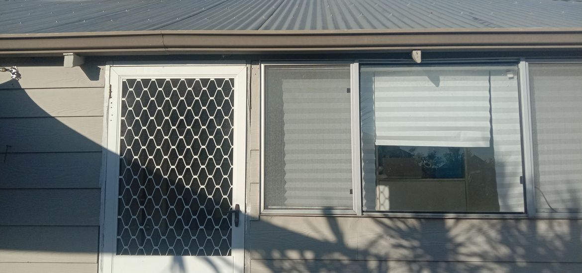

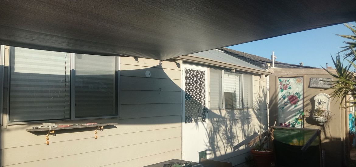

I recently bought an old weatherboard house with a sleepout at the back. The back of the house receives a lot of afternoon sun and ideally we would like to shade it with a pergola. We also need to provide cover to the back door somehow, given that it gets pelted with rain and sun throughout the year and has warped (we will replace it once we figure out a solution to shielding it from the elements).
The problem is that there is basically no clearance above the doors and windows to be able to attach a pergola. There is about 7cm above the door until it reaches the gutter which is sitting on rafters which have been cut to accommodate it. I was wondering if anyone has any suggestions about how to deal with minimal clearance when trying to attach a pergola/awning. Ideally we would have a pergola covering most of the back wall, but would settle for a cover over the door if that is all we can manage. The only solution I can think of is just going without the screen door so that there isn't the issue of it opening outwards and hitting an awning - but there would still be other issues to contend with!

In this particular instance, I suggest building a free-standing pergola with part of the pergolas roof overhanging the top of the gutter. In this manner the door and window are covered from the weather. Plus, this also has the benefit of protecting the entire area the pergola covers. Having a free-standing pergola also means that you won't have to put any stress on the house or roof framing.

With a free standing roof/pergolla the door wont need to be changed/taken away.  I Like the idea of overlapping by a foot (300mm ish) the roof, that way your are shiled from the sun, rain and you know its fixed solidly. Also means taht your guttering wont have to be moved as thats the only way I could see if you were going to attach the new pergolla to the house. The distances are all below minimal to really make me happy in the connection between house and pergolla)
Look at your pic one last time, if the pergolla is that one foot higher then the edge of the roof then your laundry will also be able to be covered and you will be dry! :smile:
