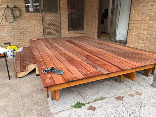

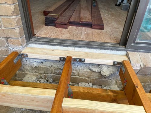

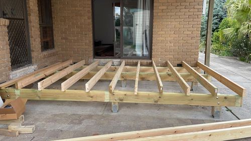

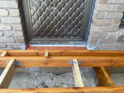

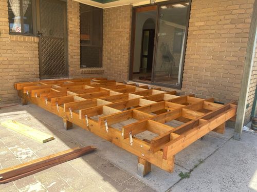

Wish you & the team at Bunnings a very happy New Year. I had time during the holidays to work on the project after consulting with the engineer on the overall design. Attached are a few photos of how the deck turned out. I did not repair the masonry work but built the deck flush with the door threshold.
For the steps, I used the wooden stringers available at Bunnings. I also oiled the subframe to extend its lifespan. Overall the deck turned out as I had expected.
