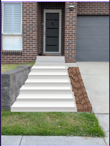

Re: Base work for Travertine Stairs?
Hi Mitchell,
Something like below?
After putting the stairs, I'm thinking of doing it like this - sorry very bad rendering:
To add to that, is it best to put concrete retaining wall blocks and then add adhesive on top for the paver cap?

Hi @toffeeapple,
Apologies for the delay in response.
Using besser blocks to create your steps is a great way to do it.
As @MitchellMc has mentioned above, just make sure the base is well prepared to eliminate any movement, they are mortared in place and then core filled with concrete.
Once the structure is in place, and the core-filled concrete is set, your paver caps can be set in place with mortar.

Hi @toffeeapple
Construction-wise, I would follow the advice by both @MitchellMc and @JacobZ . My only two additions would be to allow the thickness of the tread pavers into your finished riser height for each step. The minimum requirement is 140mm to a maximum of 190mm, with 175mm being pretty standard. The 2nd thought was to consider before laying the hard base was to run low-voltage lighting cables for future stair/path lighting. As well as irrigation tubing for the garden be right of the stairs.

My wife has suggested using retaining wall blocks (same colour as our current retaining wall) and to cap it with a lighter colour (travertine cap preferred).
Because the pathway is on a slope, will I need to dig/excavate the entire area? Meaning the the whole path is the same clear level as the ground level and then build up the steps that way? or can I install the first retaining wall block on the ground and then work my way up, dig as I go so I don't remove as much material?

Hi @toffeeapple,
Working bottom-up with your retaining blocks is definitely the way to go.
If you excavate the bottom section, add your compacted base material, set the blocks in place and then move up to the next level, the amount of excavation required will be minimised.
Each layer will retain the soil from the level above so excavation is minimised and the volume of materials is greatly reduced.
