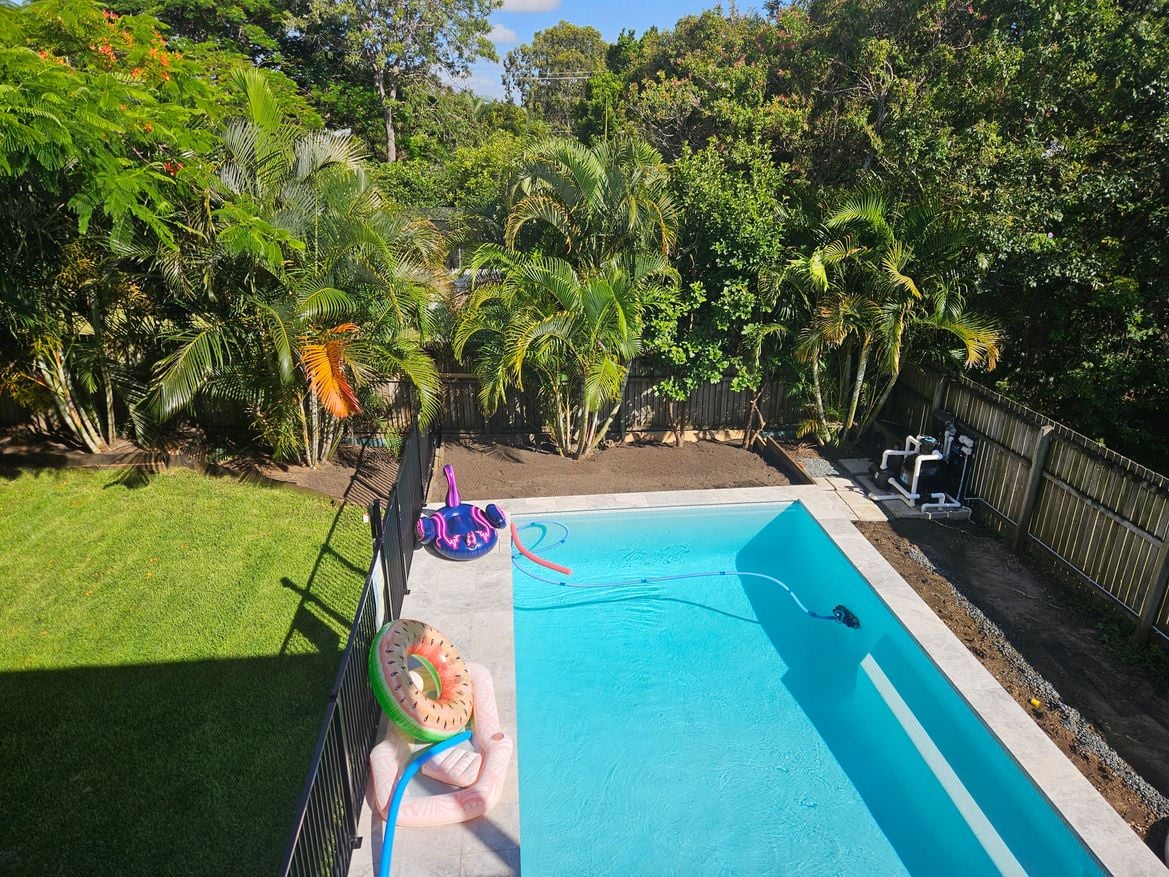

I am planning on building a deck alongside this pool.

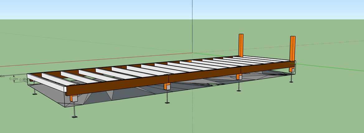

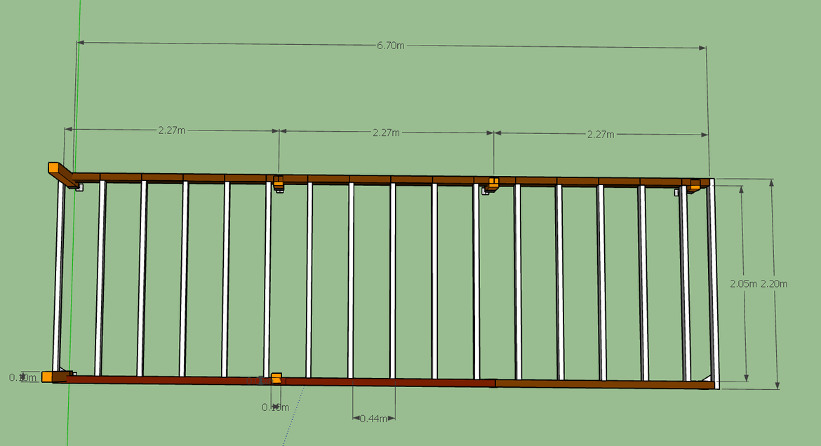

The ground slopes gradually away towards the pool filter, so I originally planned a combination of bearers on stirrups and posts on stirrups. After consulting span tables I have landed on 175*75mm F14 bearers and 100*50mm F14 joists. Plan to use SS joist hangers and screws. Noggins arent on the plans, but will incorporate.

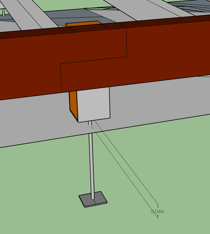

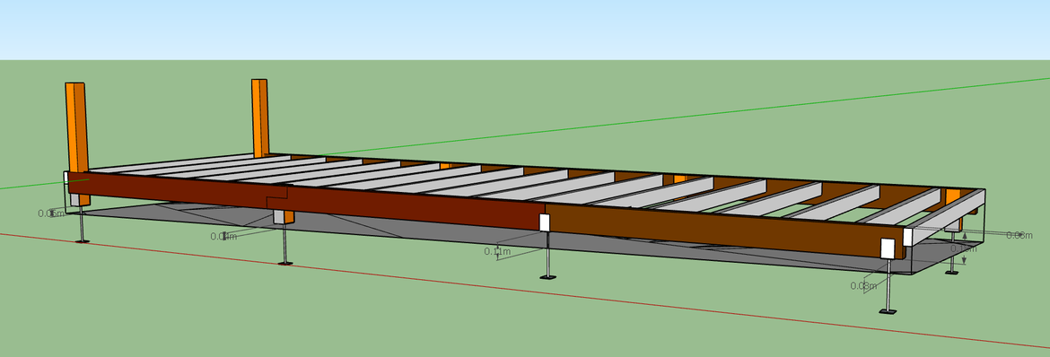

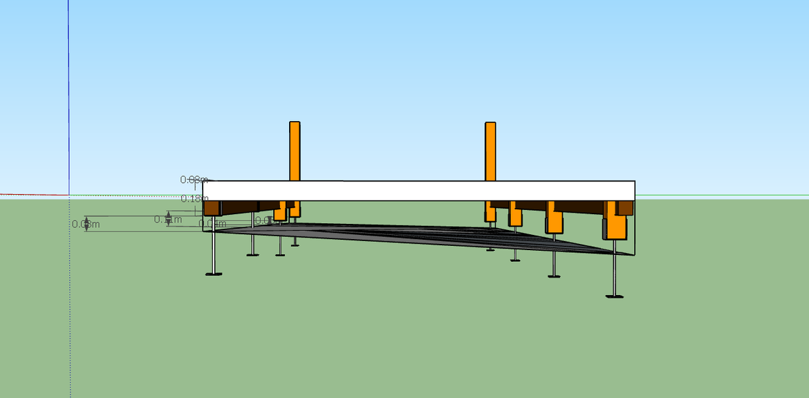

Here are my plans so far:
Here are my main questions:
**Does anyone see anything obviously incorrect about this design? I have consulted the forums and Allan Staines' manual and will use for fixings and joints. There are no site drainage issues, just pool water splashing.
**I would have prefered to use stainless steel post supports given deck is poolside. 75mm isnt available, so that would involve levelling the ground to allow enough room for a stirrup and post on the high side. Is that worth it, it will mean the site doesn't drain as freely as currently. Is Gal sufficient? It is a mineral rather than salt pool.

**I was planning on joining the bearers with a half lap joint and a nail plate on the side. I assume the best place for this is above the post, but this will block a nail plate on one side. Should the join be somewhere else?

Hi @alexanderCa,
You've already got a nice solid plan in place; however, you should check the allowable spans for the joists as the span tables I've found show 100x50 F14 Hardwood is not capable of spanning 2 metres between bearers. You will need to size up to 125x50mm F14 Hardwood, which is capable of spanning 2.3 metres between bearers.
Stainless steel hardware should definitely be used where possible as it is much better at resisting the corrosive effects that are present around pools. You can always use a larger stirrup such as this VUEPRO 300 X 90mm Stainless Steel Full Stirrup Post Support and add packers inside the stirrup before bolting it in place.
I couldn't tell you an exact figure for how much life expectancy you are gaining, but stainless steel is the most durable material in an application such as this, so it is worthwhile using it.
I prefer keeping the in-ground contact of timber and concrete to a minimum, but if you'd be more comfortable using an H4/H5 post, it would be worthwhile coating it in a bitumen membrane to help prevent decay from the wet conditions.
Your half-lap joins should be located directly over a stirrup. Using a stainless-steel nail plate alongside screws through the top and bottom of the joint will create a nice solid connection. If you are using a 90mm stirrup, then there will be plenty of clearance for this nail plate.
All in all, you have a solid plan that I'm excited to see come to life.
Allow me to tag @Dave-1, @TedBear and @Nailbag to see if they have any thoughts.
Hi @alexanderCa
Super impressive set of plans there. @JacobZ has covered off all your questions just as impressively. The only thing I would add is the use of Protecadeck strips on the joists. And to consider by sub-floor stage and requirements for running low voltage lighting cable. A very long time ago when I had a pool with a surrounding deck I built, I also added tubes to drop in umbrellas for both deck seating or pool edge shade for the kids.

Thanks Jacob. I must be misinterpreting this table. I will up the joist size. I have decided to move to 90mm posts which will work with the strirrups you have linked and dig out the depth as required.

Evening @alexanderCa
Nice plans
And @JacobZ and yourself have already sorted the only thing I saw an issue with (the span between posts)

Hi @alexanderCa,
The information I could find on spans for F17 Hardwood was very limited and you're interpreting your span tables correctly, so it is likely fine to use seasoned 100x50 F17 hardwood for your joists.
If you wanted to be absolutely certain your deck was strong, then it would be worthwhile bumping up the size of the joists, but based on your span tables, it is likely not necessary.

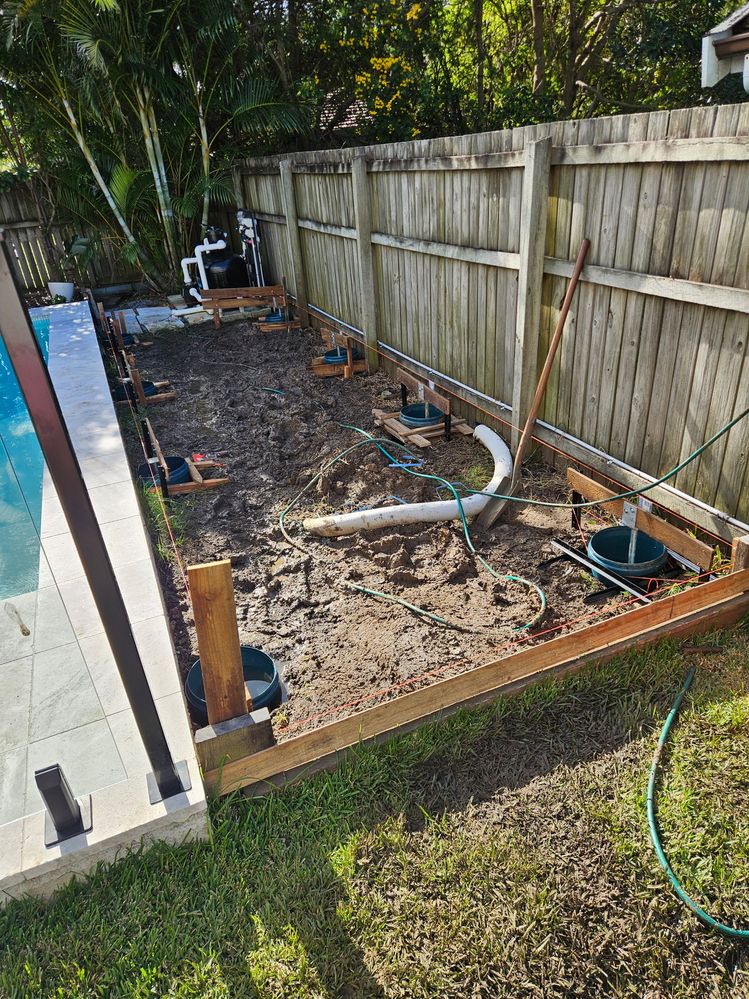

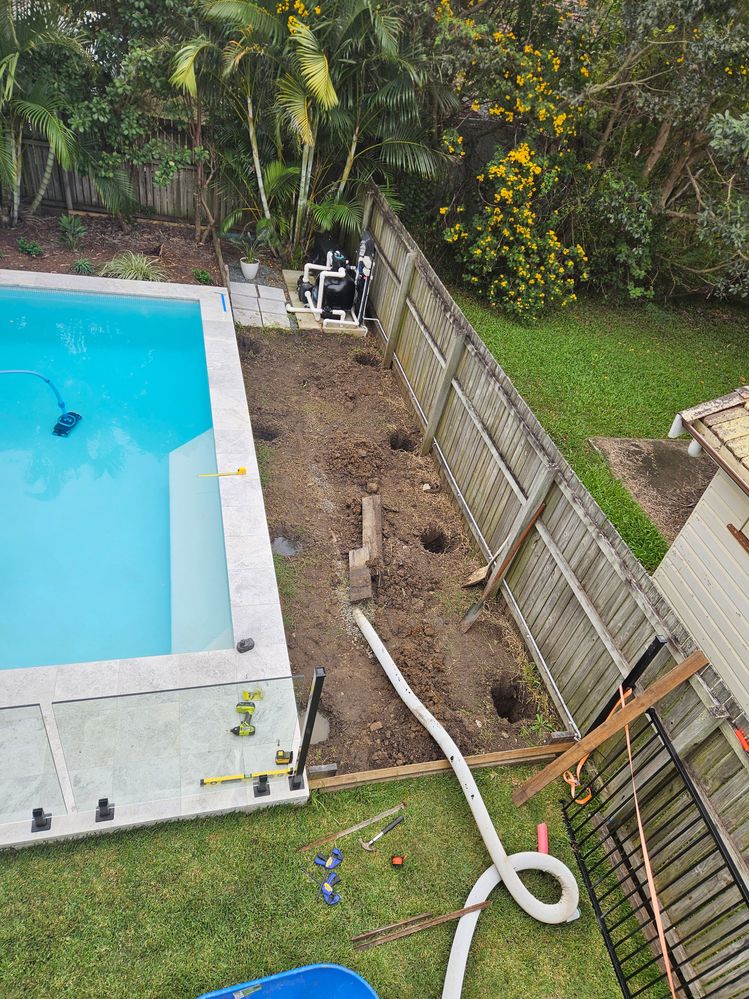

Providing a status update on my project. After lenghtly delays due to other committments, work has begun. Footer holes were dug this week. Was aiming for 60cm deep and 40cm wide. Trenching and regular shovel were fine for getting it done. No auger needed, especially with all the rain we have been having. Groundwater found its way into the holes to varying degrees.
I decided to run bearers on stirrups and raise the level of the footers where necessary to level off the deck. A mix of very short / no posts felt excessive.
Next step was stringline marking out where the stirrups will go. I wish I bought/hired a beep laser for this. The Dewalt 360 really struggled in the daylight. 4 string lines took an unreasonably long period of time, but I am pretty confident its square and level now.
After getting ready for formwork today, it of course poured rain last night, filling the holes completely and turning the site into a mud pit.
Still, no reason not to proceceed. Pumped out the holes and formed up the stirrups and bottomless buckets which I am using to raise the footers above ground level where necessary. Next step is concrete taxi. Following that I plan on reworking the drainage here, grading back to a level slope and covering the area with aggregate.
