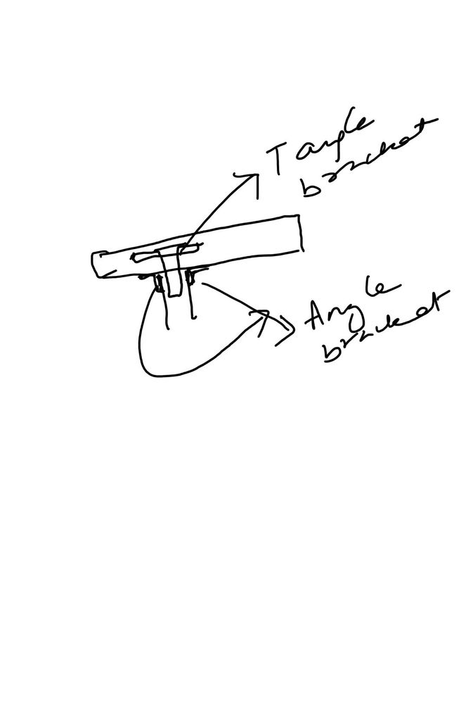

What options have i got in case i am not able to notch the bearer on the post? I have seen elsewhere ( on the internet, professionals doing thatbearer and postbearer and post) the bearers sitting on the posts direct. I understand its not recommended. But, if that was the only option i have got, would using angle bracket in conjuction with the use of T bracket work? as per the attached image. Ravi

Yes, it is possible to use a nailing plate or large T plates to anchor the bearer to the post. Adding an angle bracket might add extra support. However, I still suggest doing a single lap joint on the post to hold the bearer in place as you can use a nut and bolt fixing which is much more reliable.
Let me tag @JacobZ just in case he wants to add more information.
