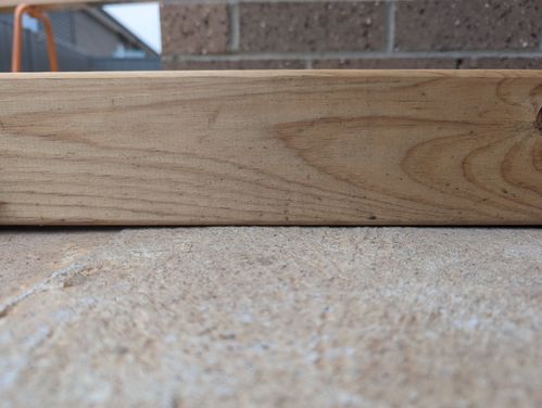

Some minor challenge came up when I finally moved the whole thing to near the brick(towards doorway, and wall).. Since the concrete slab isn't even, some of the timber "touches" the slab a bit. Some, timber, maybe I can still put something underneath, but some are like this:
Any suggestions on how I will handle this? What should I do on the section that touches the slab?
Thank you.
Re: How to build a low-level deck?
Hi @yeahboo,
The only concern I have with the timber sitting on the concrete is the possibility of water being sucked into it every time it rains and possibly creating an area where decay could develop. I recommend painting the underside of the timber where it touches the ground with at least two or three coats of bitumen rubber.
