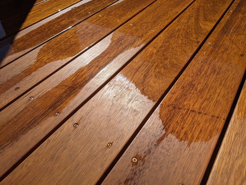

Yeah, I'm kind of going of how it's currently drying to figure out how much oil there is from 12 months ago.
Top photo is the boards that have taken most of the weather, bottom photo, not so much.
Re: How to build a low-level deck?
Hi @IronStan001,
I'd just give it one good coat, allow it to dry and then reassess.
It's hard to say from photos, but one will likely be enough.
If you aren't happy with the results, you can always add a second coat.
Let me know how you go.

It's actually amazing how much oil soaks into bare timber.  My first 2 coats after laying the deck consumed the entire 4L, so much so, I really had to squeeze every last drop out of the brush to make it to the end of the 2nd coat.
This time, I think I've used just over 1L for the maintenance coat, and I was soaking the brush and being pretty liberal with its application.
Hi @IronStan001,
It can be a bit of a shock, but when you consider the volume of timber and the way the oil soaks between the wood fibres, it makes sense that a decent amount of oil is necessary.
Ultimately, your deck looks fantastic and I'm sure it will serve you well for a year or two until you need another maintenance coat.
I'm sure the experience of the first few years will prepare you for the next time you have to oil your deck.
