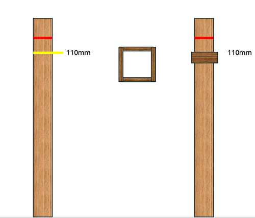

Since you have already created a cut line with your laser level, the next thing is to carry that line with a pencil around the all 4 sides with a square on each post.
I would definitely not use a reciprocating saw to cut the top of the posts as you will not get a clean straight cut. This needs to be done with a circular saw.

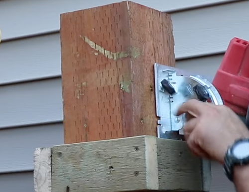

Measure the distance from the inside edge of the blade to the furthest edge of the base plate. Lets say its 110mm. Then measure down from your cut line 110mm and draw that all the way around.
Use DAR Pine to make yourself a cutting guide thats has an opening slightly larger than the post diameter. Screw that to the posts with the top edge on your 110mm line.  Depending on the depth of cut of your saw, you will need to cut on multiple sides to get all the way through the post.
Cutting the top of the posts is relatively dangerous as there is a high chance the saw will kick back. A sharp blade is important and go slow.. Carry each cut so the blade has passed all the way through each side. You need to position your body height safely and securely so you're not cutting any higher than chest height. You will need eyelet and hearing protection.

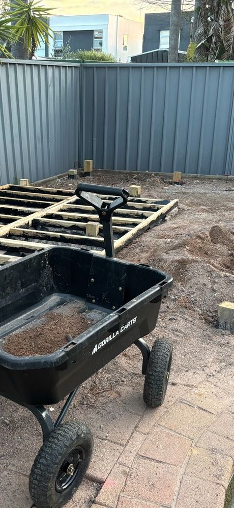

Do you have a photo of the corner you are doing as I am thinking support siws you dont want it cantilevered too far from a support to the ground?
If you think it will flex with a body weight then I woulkd suggest to install another footing. There is nothing worse then a deck moving undre your feet :smile:

Thats a pic of the corner.
(Don't laugh at the post stumps/footings - I know they aren't perfect lol)
I will go back and exchange for H3s I think.
What do you think?
