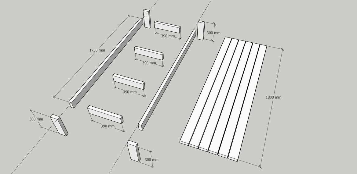

Re: Help! Measure twice cut once - lounger
Hello @awmallery
It's great that you've received sound advice from @r23on. Since you've decided to simplify the project your cut list will actually become shorter. I've tried to find the closest equivalent timber size for your project. You can still follow the video tutorial but you can skip the lounge backrest part.
Here is the timber list.
  • 2 x 1730mm x 90mm x 35mm (sides)
  • 4 x 390mm x 90mm x 35mm (centers and ends)
  • 4 x 300mm x 90mm x 35mm (legs)
  • 6 x 1800mm x 90mm x 35mm (top/seat)
Because the timber you're using is 2mm wider, please adjust the gap between the timber seat accordingly. Please note that this timber needs to be painted with a minimum of two coats. I suggest painting the timber before assembly. I recommend using Zenith 10G x 65mm Tufcote® Countersunk Rib Head Treated Pine Screws to hold the timber together. I've made a basic plan for you to have a look at. Please tell me what you think.
If you need more advice or information, please let us know.
